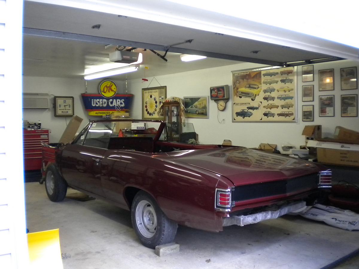

By 2010 with the body was back on the chassis and the Madeira Maroon BC/CC applied to all panels it was back in my garage, where it sat for several more years. (One of my pix shows it during this time period).
