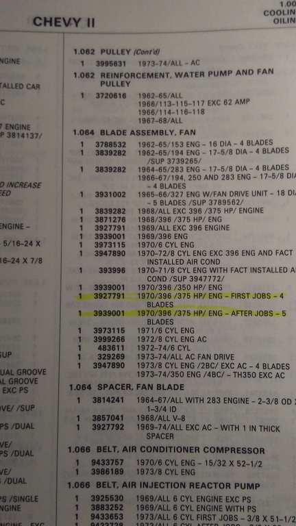

Originally Posted by Therocknss View Post
Does anybody out there have an original early build 69 l78 Nova? Sure would be nice too see what an original car had.
FWIW the gm nova product information program shows 69 396 with a 5 blade but 1970 396 375 hp first jobs with a 4 blade , heres a pic.
