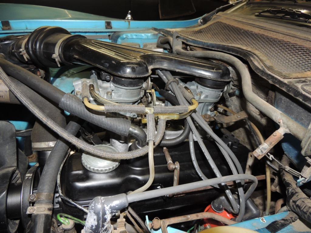

Hells bells, I am on such a roll, why stop? I started the little Opel GT on friday. First time it ran since 1974. I noticed a little seepage of water on the pass side from the head. Crap; maybe I should have used a thicker head gasket or used some sealer. Well, pulled the carbs and intake today, along with the valve cover and retorqued the head. Book says 35 ft. lbs. I took a chance and torqued to 45. I know some guys that put 45 on hose clamps... you know who you are... surely these head bolts can take 45, right?. Put it back together, and started it up. Running a straight pipe right now, as I am waiting on the muffler (found one in Italy... so it could be a while. The twin one barrels had been sitting for 34 years when I disassembled them and rebuilt them last year. I checked all the measurements twice and had to do very little adjusting. Sounds like I am bragging (maybe I am a little bit) but the ONLY adjustments I made after setting the timing (put it at about 8 degrees advanced for initial) was to screw in the main idle valve, then set the mixture screws. Only had to move the mixture screws about 1/4 turn in each. Have to wait until the exhaust is all together to fine tune it. I welded in an O2 sensor bung, so I could hook up an AFR meter and see exactly where things are. Will play with tuning later to get max mpg.
