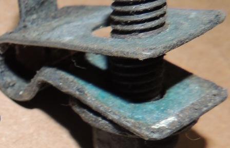

Resto houses sell kits. Not sure anyone has this correct. Rick Nelson says the Chevelle's are all over the place on coloring.
Inline tube sells this kit which is an "exact duplicate to the factory original clips": http://www.ebay.com/itm/69-1969-Camaro-Z...9db&vxp=mtr
HB Jimmy sells this kit which is "assembly line correct":
http://www.ebay.com/itm/1969-Camaro-Brak...d20&vxp=mtr
Neither of the above kits match up with what is on my car. I have all original brake lines.
Hard to find much paint on my originals. Have attached four pics. Two are a 3/8 (with locator pin) that I swear has remnants of pink paint on it. It isn't phosphate. It is paint. I haven't seen any info on pink clips. Other two are a 5/16 (with locator pin) with a dark aqua/green paint. Have 3/16 with locator pins that had remnants of black paint.
So.. for those three styles, I am mixing up some testor's paint (except fot he black) to match as best I can.
In addition, I have some 3/8 clips without the locator pins; I cannot find any color on them. Anyone know what color those clips are?
If I am way off on the others, someone let me know.
