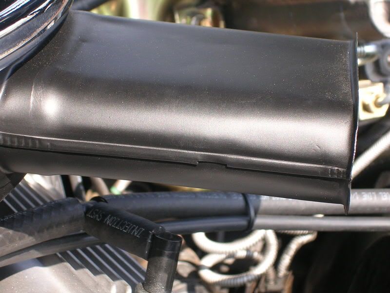

47Hammer 03-17-2008 12:47 AM
Re: LT1 Dual Snorkel
http://i14.photobucket.com/albums/a3...n/DSCN1942.jpg https://www.yenko.net/ubbthreads/imag...iggthumpup.gif

YENKO DEUCE REGISTRY 03-17-2008 06:05 PM
Pretty sure the repro's have the notches too.
camarojoe 03-17-2008 07:06 PM
They don't...but not all the original GM ones did either.
