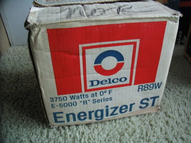

The R79W was first released in 1970 and what was included on the 1970 Chevelle LS-5 & LS-6 package as RPO T-60,and available a side option also under RPO T-60 on the L-34 & L-78 Chevelles.
I think Cumby is too busy..http://img.photobucket.com/albums/v6...ers/shovel.gif...so here is my NOS R89W,which was newly released in 1971,which is nearly indentical in every detail to the R79W.
http://img.photobucket.com/albums/v6...iesALL0006.jpg
