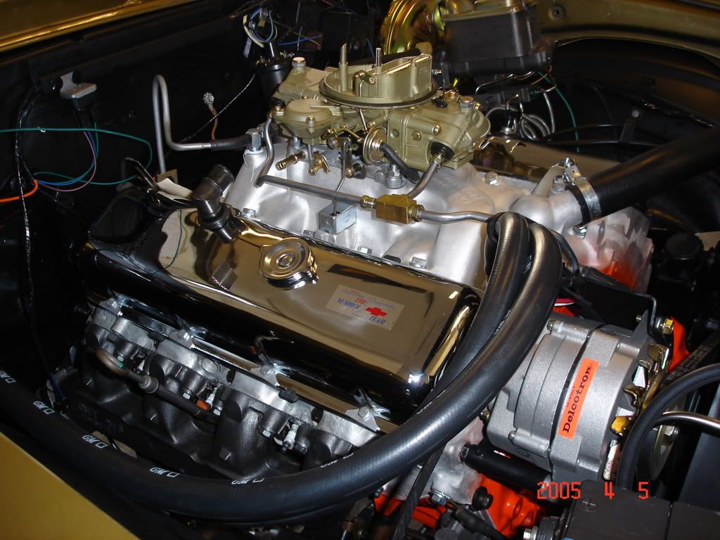

When I was doing the Engine in the Gold Nova, I tried a lot of different things to get the Aluminum Heads and Intake manifold to get that Factory look.....I ended up using Eagle One Etching Mag cleaner........Sprayed it on and let it soak for about 30 seconds then rinsed with water, I had to do it a couple of times to get the finish uniform, but it worked pretty good....Hope that "Helps"
http://i13.photobucket.com/albums/a2...z/DSC03772.jpg
http://i13.photobucket.com/albums/a2...z/DSC00871.jpg

ORIGLS6 12-24-2006 07:18 PM
Re: Cleaning Aluminum
I've used Eagle 1 'Chrome and Wire Wheel Cleaner' on bare cast Aluminum with pretty good results. (Credit Chad Blomberg for the tip.)
Most recently used it on a pair of WCFBs and a vintage Dual Quad intake, and they look like new. As with Ken's experience with the Anodized Grille, I'd be careful since it's a corrosive formula. I sprayed it on, let it set a few minutes, then scrubbed it with a toothbrush before rinsing.
May be close to the same formula Ken recommended above. https://www.yenko.net/ubbthreads/imag...lins/dunno.gif
