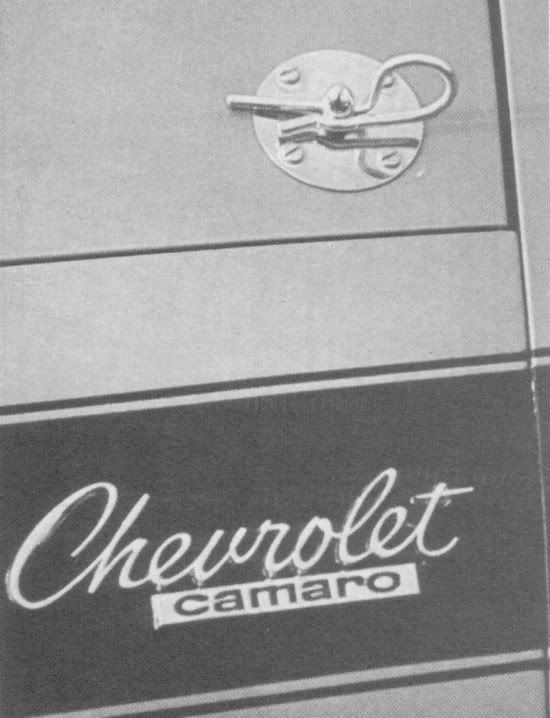

Thanks Mark. the guy I got the car from put them way towards the center of the car. I have to repair the hood and want to put them in the correct spot. I have yet to see a car with hood pins in person to verify position. Thnx again, Scott

Photo is from the 8/67 Cars Magazine article on a '67 B-M SS427 Camaro conversion.

Thanks for the pic!
