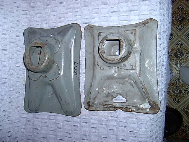

Years ago I sent a 70 Camaro jack base to PPG in Cleveland, OH for anaylis as the jack & base appeared to be same color.
PPG came up with a formula number 35517, either in DAU or DAR (DAR they commented, that DXR-80 must be used in color)
FYI The front of 70-74 Z-28 wheels is painted with DDL 32961 LAQUER ONLY No Clear Coat.....Not Very Durable, Will Deteriate with scrubbing and washing.

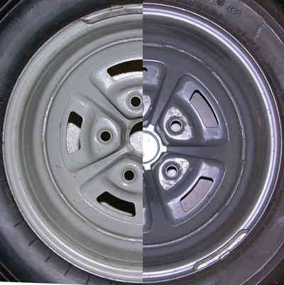

Nova Research Project 03-13-2006 06:37 AM
Re: 70 SS Wheel paint
1 Attachment(s)
WILMASBOYL78;
Do these look familiar?
https://www.yenko.net/attachments/196...sLightGray.jpg
