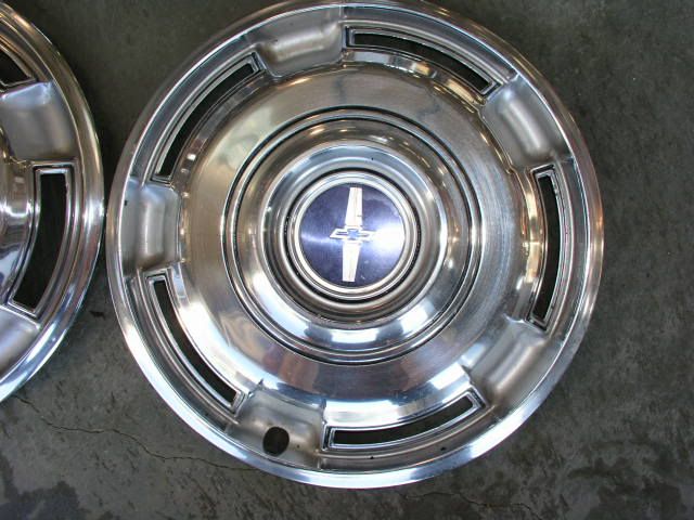

Here is a picture of the PO1's. Bought myself a complete set from Charley last year. I am going to be putting them on my 69 Camaro convertible this spring, just as soon as I get them restored. The PO1's originally came on my convertible, per the windowsticker, buildsheet, etc.
http://img.photobucket.com/albums/v6...ister1/PO1.jpg

I love those caps Mr.T....I pieced together a NOS set for my 68 loooong after finding a nice pile of used caps.Good luck! https://www.yenko.net/ubbthreads/imag...lins/beers.gif

Glad to hear that I'm not the only one with the PO1's. It gives the car a different look, versus the Rally wheels you see all the time. Now I just need to get rid of the ralley's that are currently on my vert. Got a picture of your 68 with the PO1's? https://www.yenko.net/ubbthreads/imag...iggthumpup.gif
