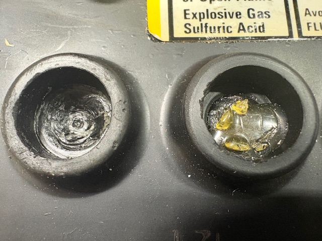

I recently acquired a NOS Y55 Delco Battery from early 70's. It has never been used. The top of the cells have a Wax material, that I thought was sealing the cells. But I removed the wax from one cell, and under that the top of the cell is still sealed off with the Bakelite material. I'm puzzled. How are you supposed to open the cells to acid ? Do you punch in the material ? It will drop into the battery which does not seem right.

you punch out the plugs with the DELCO EYE put the delco eye in there and hit it with your clenched fist I worked at a Chevrolet dealer in the sixties that is how we did it. that is why the eye is pointed on the end to punch out the plug and the pieces fall into the battery and stay there.

Thanks Ralph. Since the battery is made of Bakelite, then having the material fall into the cells should not be a problem. I'm still not sure why they put wax on top of the cells over the caps. The top cell I removed the wax. Oh well. Here are some pictures.
