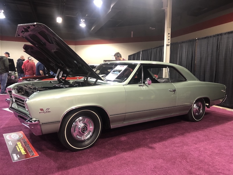

67since67 12-17-2025 05:10 PM
1 Attachment(s)
Perhaps you are thinking of this one?
Vintage Certification Time Capsule 2021, 12,000 miles
olredalert 12-17-2025 10:24 PM
----Oh,,,Did I ever look all over this beauty! The wide stripe (diameter) Firestones just were so cool, along with the rest of the car!!!....Bill S
