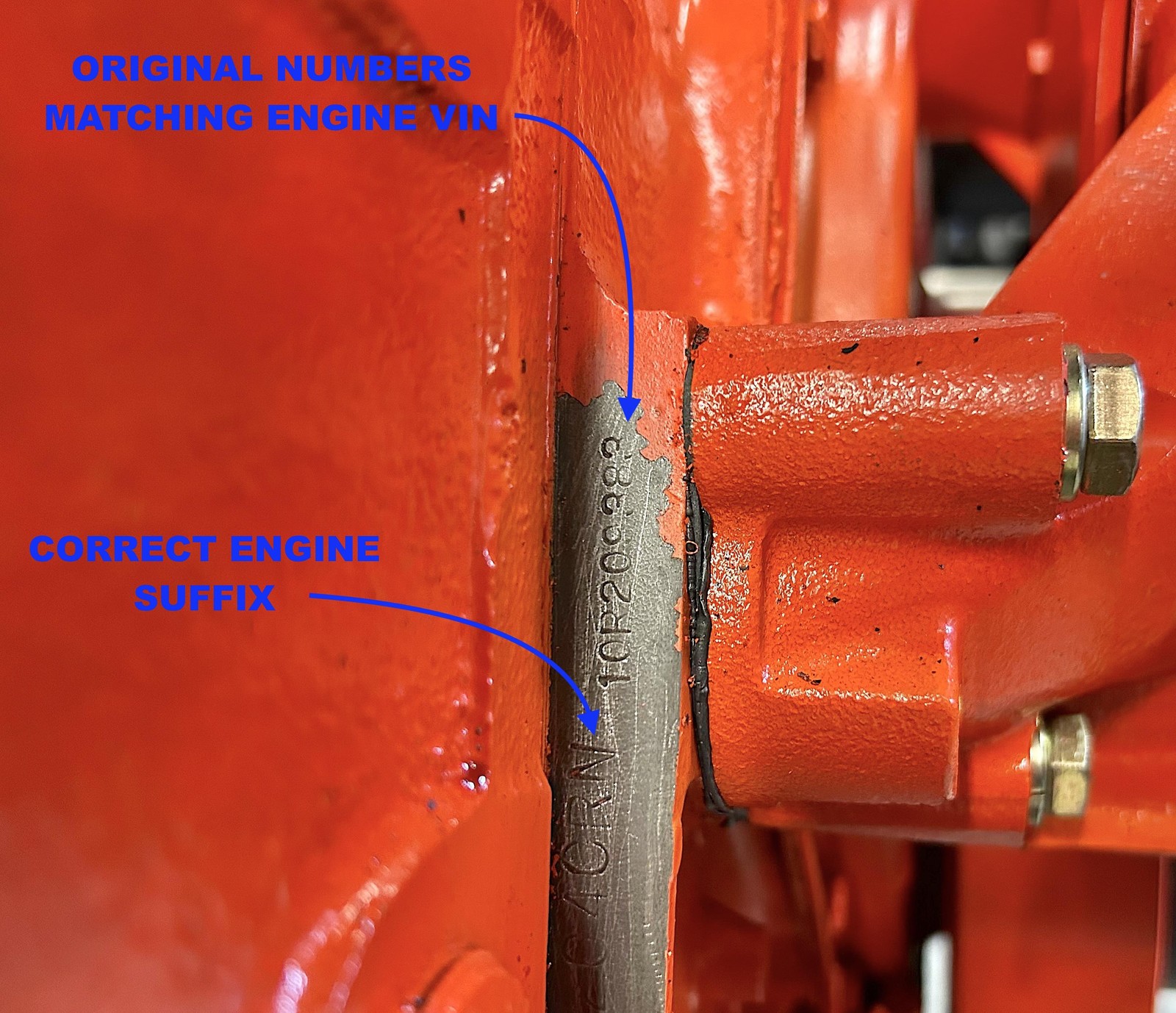

Not a great resto by any means, but appears to have its original CRN LS5 block.

Too Many Projects 11-15-2025 10:52 PM
CRN is a Monte Carlo block for automatic. CRT is Chevelle manual trans.... not original.
Which would seem to indicate the vin tag is also from the Monte "donor"...

Tracker1 11-16-2025 06:32 PM
Has 13637 VIN not 13857
Are we looking at a factory assembly line stamping mistake?
scuncio 11-16-2025 07:13 PM
That’s interesting that the CRN code is Monte specific - many of the online references show it as Chevelle with manual trans. You know what they say about truth on the internet :)
Keith Seymore 11-16-2025 10:07 PM
I can imagine one digit wrong but not two (in a fairly random way, ie not a mistake of consecutive numbers).
K
Tracker1 11-17-2025 01:00 AM
I meant the CRN versus CRT, did they stamp an N when it should have been T.
scuncio 11-17-2025 01:04 AM
Must be, or an incorrect block was stamped with this car’s VIN during the build.
Too Many Projects 11-17-2025 01:27 AM
The build date code on the block should have 4 numbers. We only see 2 ...04CRN. Wouldn't that be the month of assembly, as in April ? The build date on the trim tag is 02A
Restamp vin on block ?
luzl78 11-17-2025 02:55 AM
Looks like the number 2 before the 04 on the pad. Could be 0204 CRN which would match up with the build date.maybe it was misstamp CRN instead of CRT.
