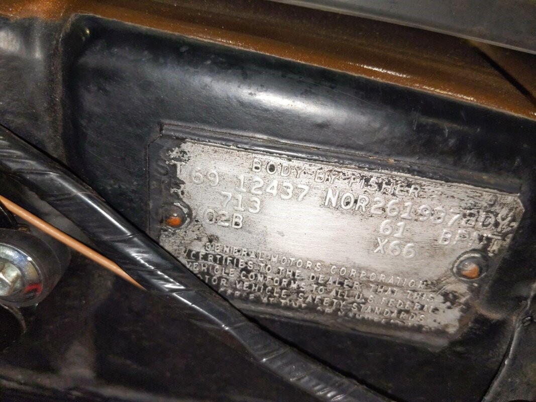

Cool color with a good looking trim tag. Looks like the block has been decked at some point but mildly so, and the numbers are still pretty legible. Does this VIN (124379N599390) still fall within the timeframe when Norwood was stamping partials on the deck versus at the bellhousing flange?

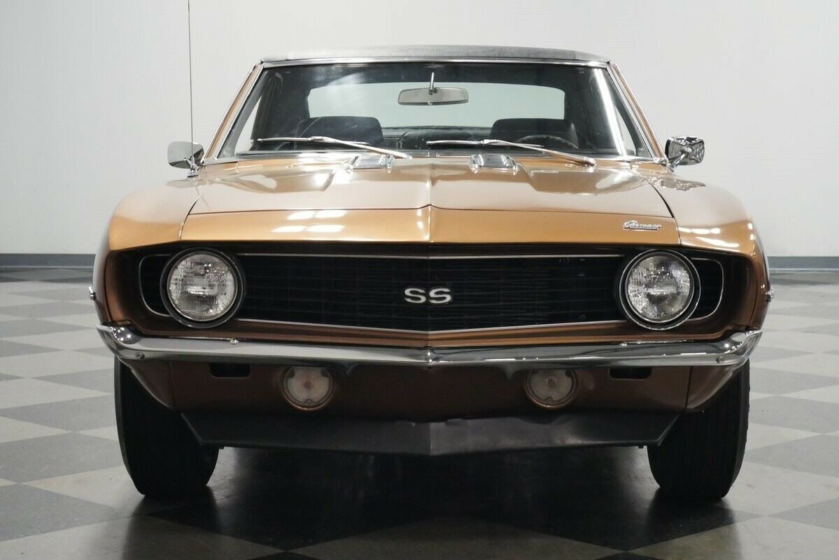

Wondering what's going on with the vinyl trim 'halo' stainless - almost looks like the clips were reinstalled in the wrong spot and the top is 'receding' more than it ought to.

Passenger side top trim on the sail panel sure looks messed up. Cool car though
Jonesy 03-31-2022 02:56 PM
Front fenders both are poorly fit and have the common fender droop.
The pad stamping pic doesnt show the whole stamping and that VIN looks like it was added.

----Agree with all the above. Add to that the fact that the color is no where near correct Burnished Brown.....Bill S
Was thinking the same thing Bill, a few shades off for sure.
Beat me to it Bill. That is NOT Burnished Brown!

Not even close to BB. It's such a dark brown that it appears black in many pictures. And holy fender droop Batman! If this were a real L78 it would deserve much better.
