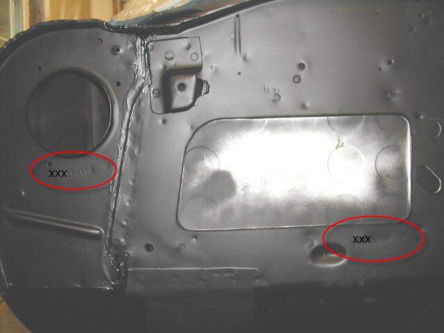

https://i.postimg.cc/9fjFhMLL/balt-68ss-firewall-01.jpg
This 1968 Baltimore SS396 has the partial VIN stamped in two locations on the firewall; one under the heater core box and one under the blower motor area.

dustinm 10-06-2021 01:21 AM
My Kansas 68 only had 1 hidden stamp but I dont recall if it was by the blower opening or under the core opening. I did not find anything on the left rear corner of the frame where other guys have claimed a partial stamp.
