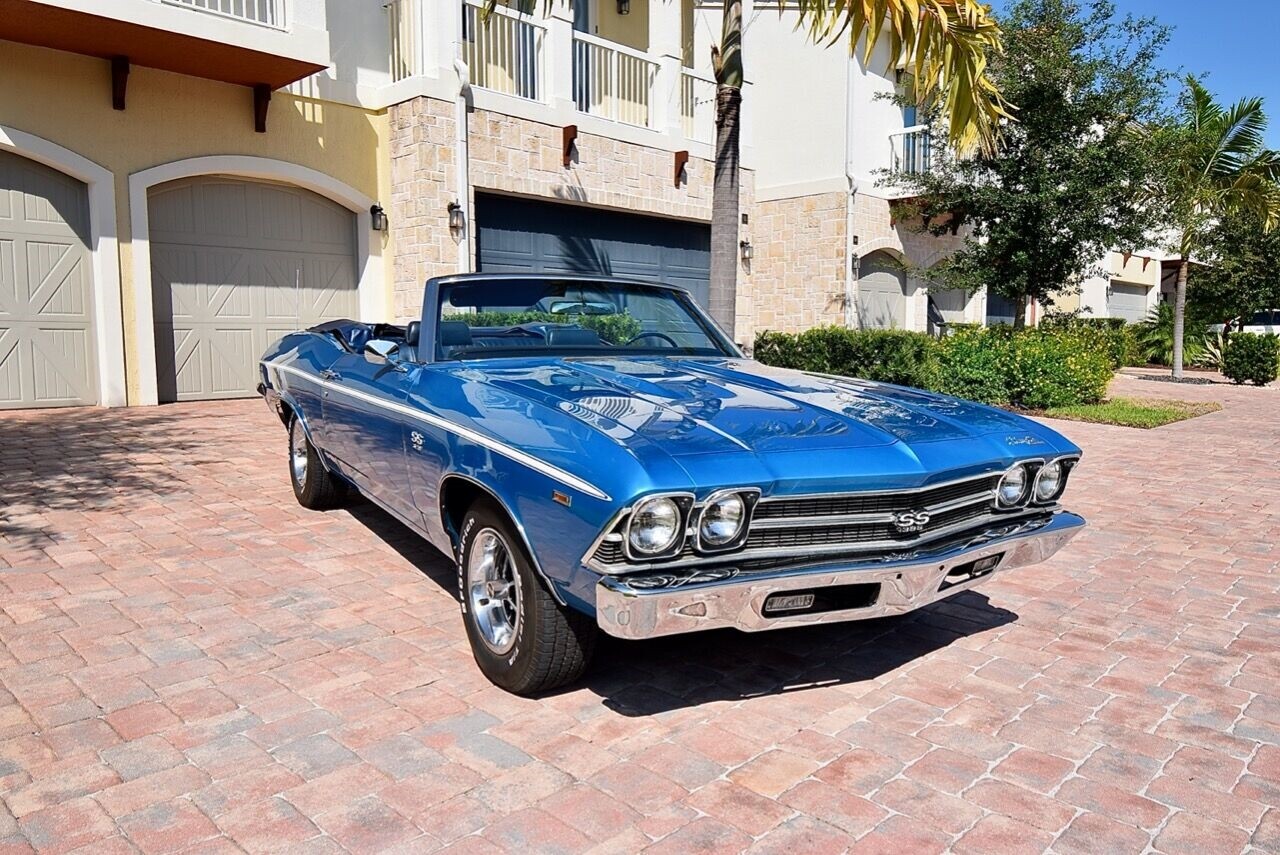

Looks like a nice car and I dig the blue on blue color combo - don't see a lot of blue interiors on '69s. Interesting that the car has a KK 4.10 rear - again, not something commonly seen with a 350hp car.
Classic nonexistent auction description and not even a picture of the alleged POP, so I can't say much more about this car other than the pics are intriguing.

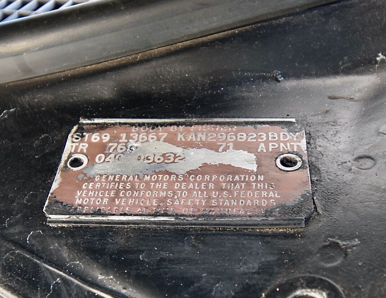

Kansas car with no L on the trim tag probably not a real SS
Ryan1969Chevelle 10-30-2020 11:35 AM
The L is a very consistent tip.
Or lack there of.
Ryan W31
BLACKLS5 10-30-2020 12:55 PM

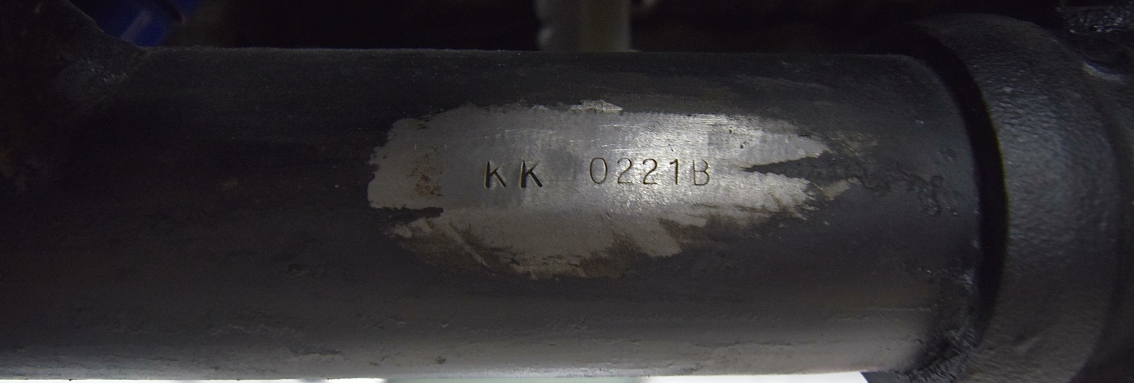

It sure looks like that axle tube has been sanded down at one point.
BLACKLS5 10-30-2020 01:39 PM
Also notice the 3rd digit of the interior code on the cowl tag has been obliterated so we can't tell from the tag if it was a bucket or bench seat car. How clever...
