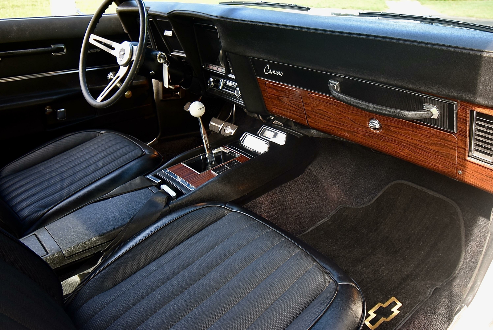

Clean car, trim tag looks OK to me, and I'm glad it's still in the original color combo. Comfortweave sure looks sharp against the white exterior.

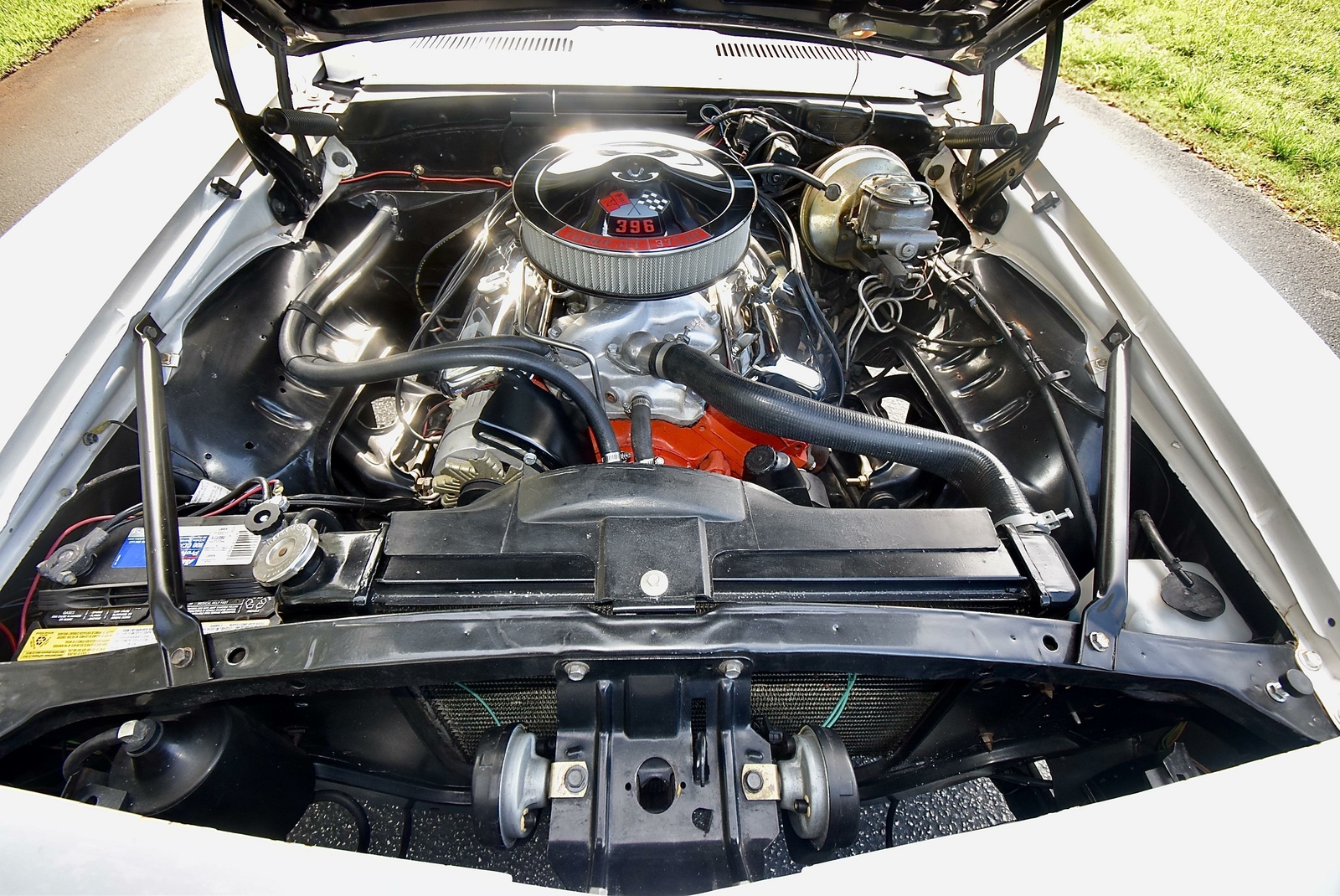

Sounds like it's NOM since the seller references a 'correct' engine.
First thing I'd do is throw that brake booster in the trash....

...and those horns. Then get a correct shifter handle.

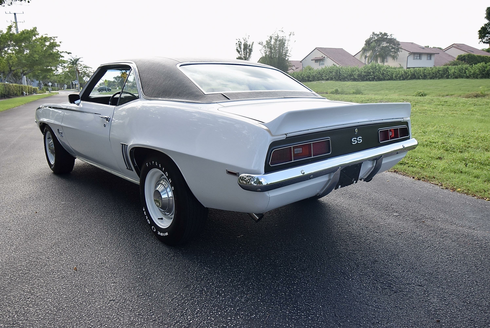

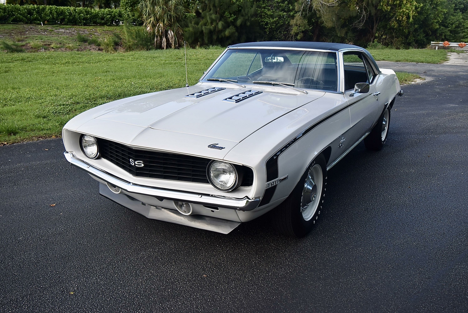

Wasn't originally tach/gauges or spoilers. Needs the correct vinyl top also. Master cyl is also wrong. Looks like they put a late alt on it. Some easy to fix. Despite all that, it's a clean car. Always liked white cars....Joe

What the heck are those round holes for under the frame mounted bumper brackets on the lower valance?

I'd stay clear of this car.... No clock, wrong booster and other ridiculous after market parts...and worse yet.. FAKE trim tag !!
