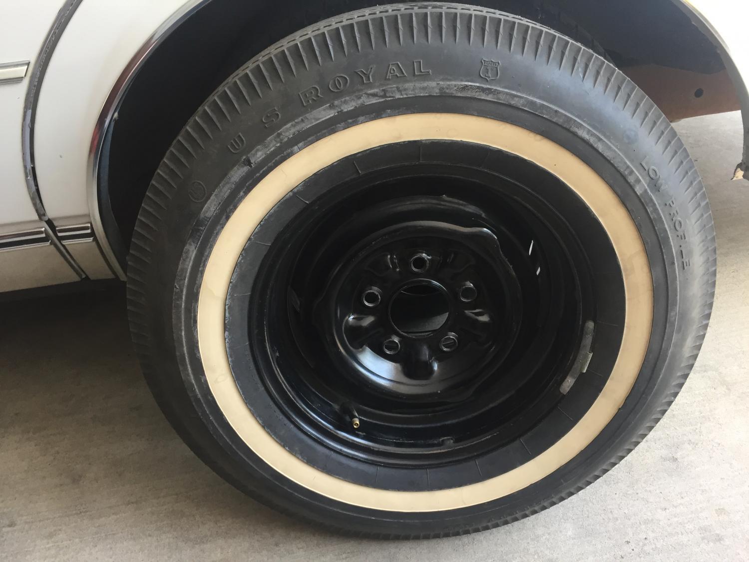

I'm trying to figure out the date of manufacture of a spare tire found in a '61 Impala. The tire reads:
7.50-14 safety 800. US Royal
Spare also says low profile tubeless. 1207-154 AA 686. 4 ply rating 2 ply. 20XD4
Any help would be appreciated. Although the size is correct, I have a hunch it's not the original spare. The wheel shows signs of being mounted and the tire has wear.

Attachment 165284

Verne_Frantz 05-03-2020 02:23 PM
That's a good reference Lee. Thanks. I understand now that prior to the DOT mandate (which I thought was 1968) each manufacturer had their own dating methods. Since US Royal is out of business, I doubt I'll be able to decode the date.
Let's just suppose the 1207 indicates (1) the year, 1961, and 207 is the day of the year. That would make the manufacture date the 4th week of July, which just happens to be the week this car was built!
This tire also says low profile tubeless. 4 ply rating 2 ply.
Verne
