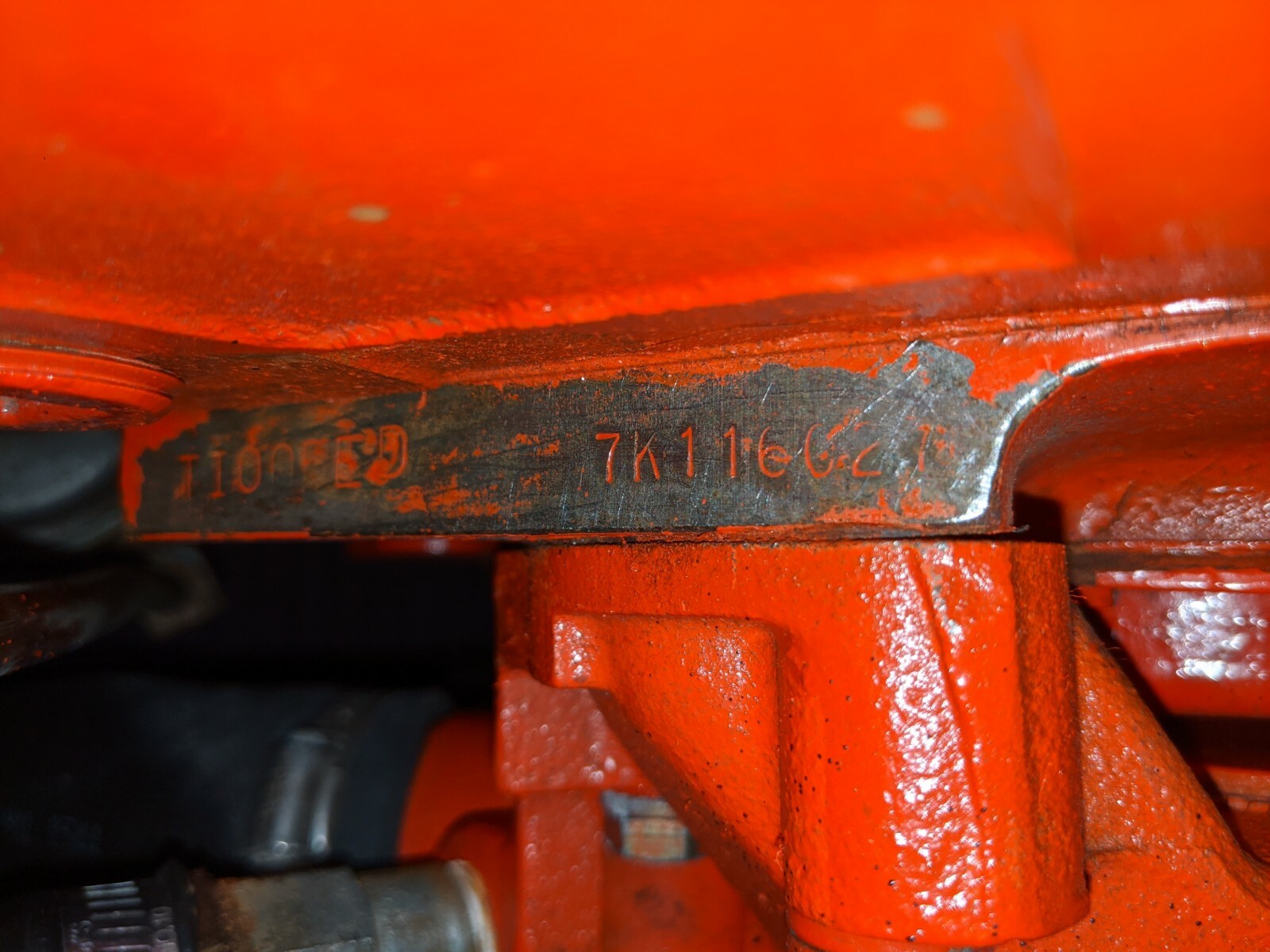

At least the correct VIN 138177K116027 is posted this time w/ fourth last digit 6, not 3.
Good info on the bellhsg/trans also yep, sure looks like a painted rivet or pan head screw.:hmmm:
:beers:
