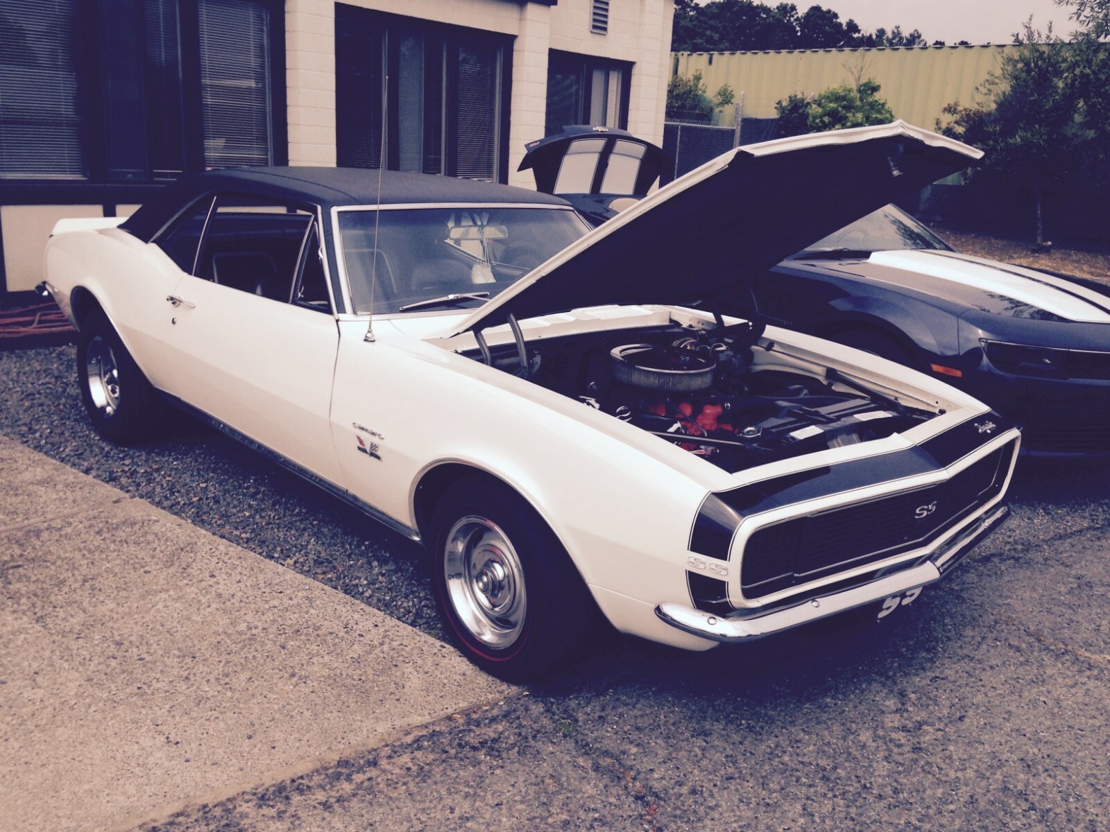

Interesting car with only a rubbing of the trim tag indicating the 4K code, and a repop window sticker. Not a lot of information to go on, but could get more interesting if it still has the born-with block.

427TJ 11-27-2019 06:26 PM
396 flags are about an inch too high from the stock location.
luzl78 11-27-2019 10:13 PM
Too early to be a L78 car. Built in December 66
BARRY 11-28-2019 12:36 AM
intake
no aluminum intake
wvhylander 11-28-2019 01:33 AM
Looking at the fuel line, doesn't look like a Holley.
Zedder 11-28-2019 02:01 AM
Fake tag for sure...
the427king 11-28-2019 02:24 AM
961 block is wrong. Located in california and pics show connecticut early American plate....
scuncio 11-28-2019 03:18 AM
With a repop tag predating L78 availability, all bets are off....
Kurt S 12-01-2019 06:08 AM
I have a picture of the original trim tag - 4P.
