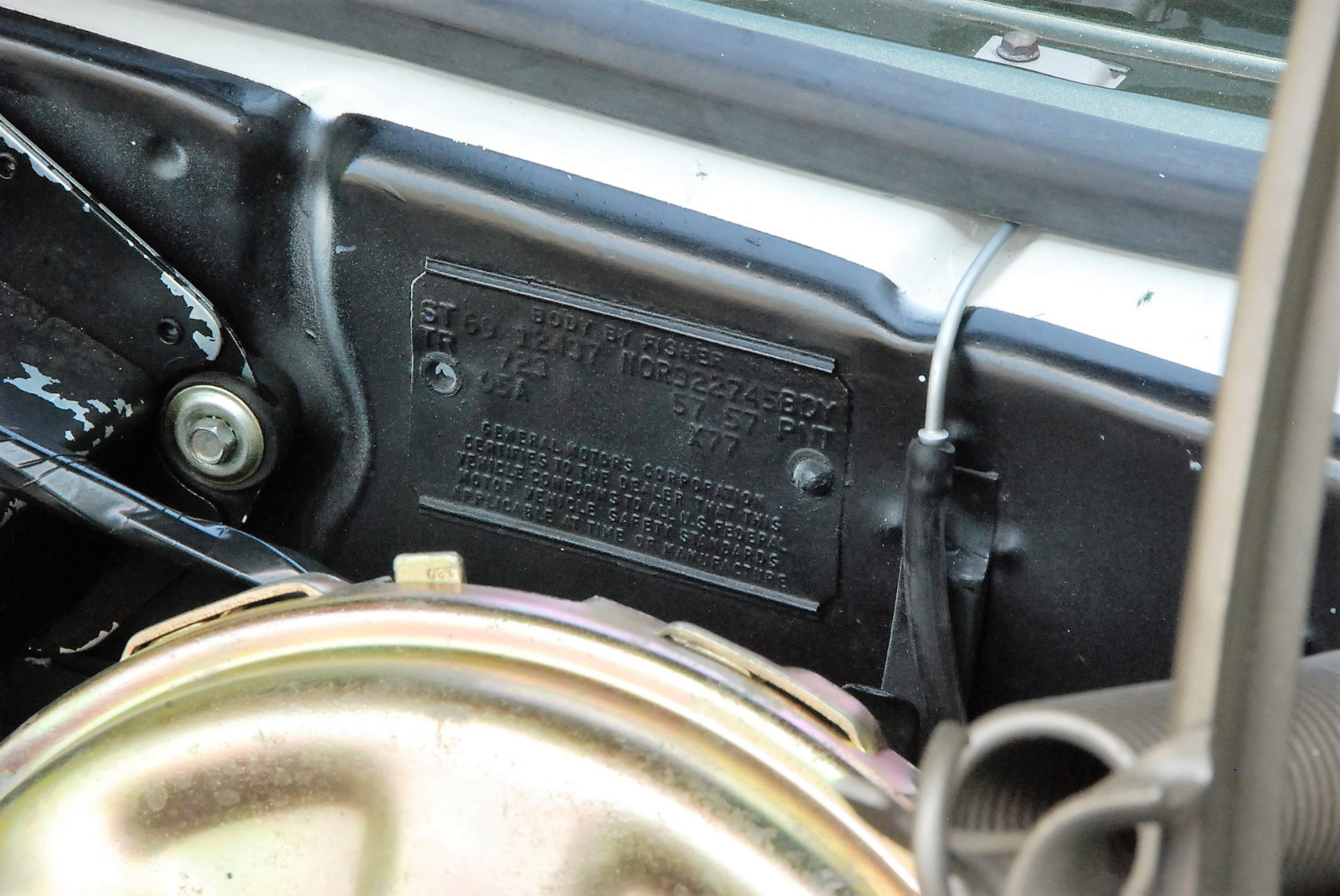

On youngs car the trim tag is painted and this one is black. Is that normal or did different factory's paint them?
sixt9rsx33 10-20-2018 12:25 PM
Firewall was not painted body color, but black, however, the firewall had body color "feathered" down the firewall. Think of body color overspray down the firewall.
sixt9rsx33 10-20-2018 12:26 PM
This green car firewall is not restored correctly. The factory did not have sharp lines like this.
