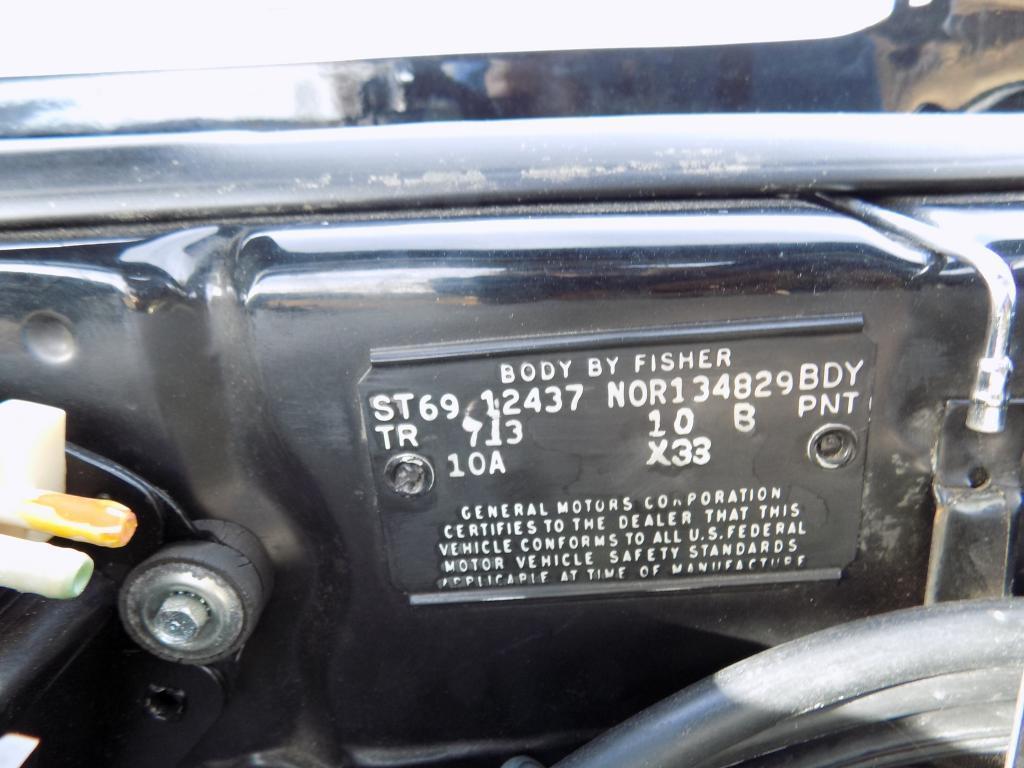

Did this guy use white-out on the trim tag or what?

If it's 10A of 68, it wouldn't have an X code. If it's 10A of 69, should have D80, so somethings wrong.

I don't know but I grit my teeth every time I see one of these tags sandpapered.
DW31S 02-15-2018 12:14 PM
Looks like they hit every page in the catalogue.
NorCam 02-15-2018 12:27 PM
Lots wrong with that car, and third person to list it this month. Lipstick and makeup on a pig I would say
Here was a previous eBay seller ID he_phip_nggkek (3 )
Steve Shauger 02-15-2018 12:47 PM
I believe this car has been discussed and there are many questions. Love the rear antenna and spoiler. And the tag well......
Jonesy 02-16-2018 05:40 PM
124379N695328
That tag is not legit
