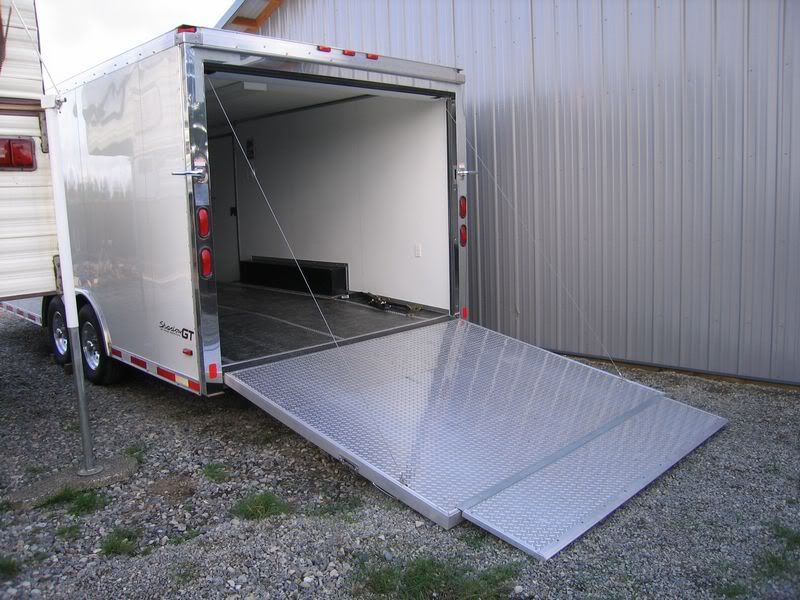

CamarosRus 05-14-2016 10:42 PM
Mounting Elec Winch in My Enclosed Trailer ????
Asking to SEE PICTURES of Elec Winch/Battery Installations so as I can copy to mine.
20' 10K Pace American Shadow GT
Planning on buying ??? from Harbor Freight
Concerned about cable cutting or marring vinyl floor at rear of trailer ???
Concerned about adding additional steel under trailer
I have MIG welder and steel
http://img.photobucket.com/albums/v4...ToolBox019.jpg
http://img.photobucket.com/albums/v4...TRAWpic004.jpg
http://img.photobucket.com/albums/v4...epair079-1.jpg

CamarosRus 06-09-2016 04:41 PM
Re: Mounting Elec Winch in My Enclosed Trailer ????
I still have NOT yet mounted a winch in my trailer, but did pick up the cheap ($49.00) 2500# with remote Harbor Freight model.
Has 50 foot of cable and only two mounting holes.
You can SEE ABOVE my trailer has a Vinyl Floor. Also has three recessed aluminum tracks running front to rear where adjustable
hold down rings can be inserted/fastened.
I do NOT want the cable to drag on vinyl and mar the vinyl....How about if I had several thin nylon/plastic one foot long "bars"
attached to floor in center that cable could glide over ????. Know that they could be tripping hazard but they would be brite in color !!!
Anybody else think having battery above winch is good idea, or better on the floor over in far corner under 110Volt wall mounted
shore power box ????
THANKS for those that SHOW ME pictures or send me pictures
