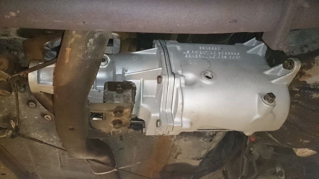

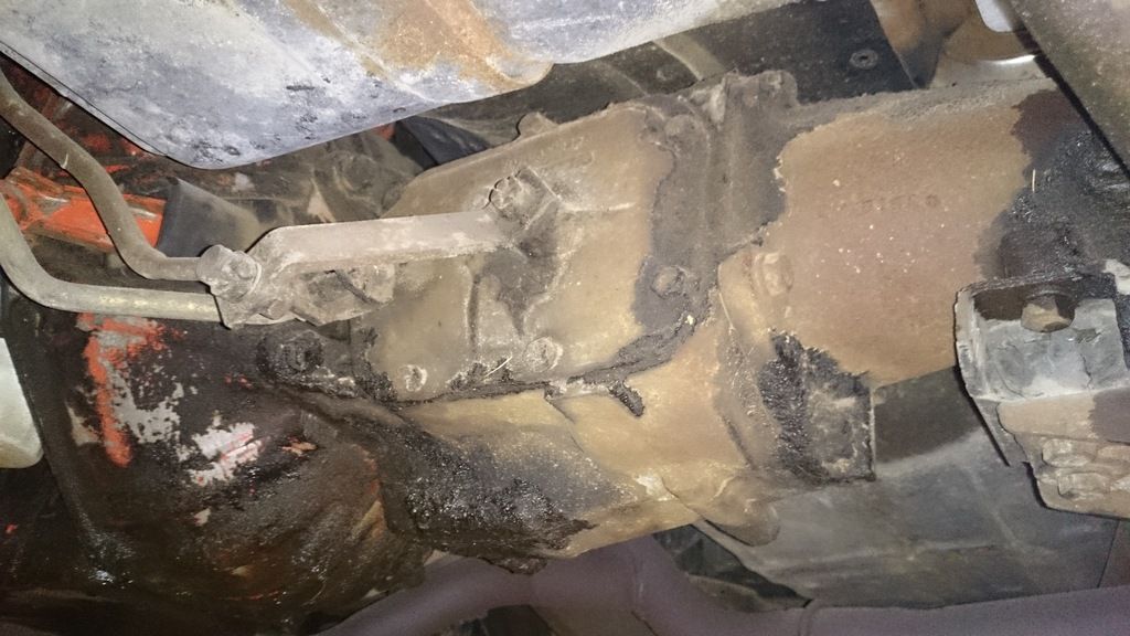

Here is the Three speed tranny with the old three-on-the-tree linkage

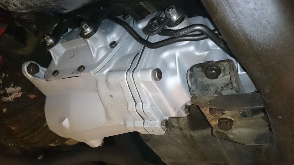

and here is the elkie and cross member with a temporary M22 4-speed in place...
http://i247.photobucket.com/albums/g...psn5weoqy6.jpg
http://i247.photobucket.com/albums/g...ps8d41nzgk.jpg
I believe this is the correct cross member to bolt an original Muncie shifter to, but I'd gladly put in a Hurst 3-speed shifter if I can get one for a reasonable price.

marxjunk 04-11-2016 09:22 PM
Re: WTB 1968 Chevelle 3-speed floor shifter
no i dont think its a floor shifted stick shift cross member...it has hurts linkaage and shifter..
you see the bracket the trans mount is on? theres another on the other side for a stick, one bracket faces forward,,the other faces rear... it doesnt mean your stuck..it means the factory shifter pic'd above has no where to mount
so, if you want to use a stock shifter you need a cross member also
its been re-poped i think...but maybe not..because you also have the prob with the elcamino has a boxed frame like a convertible...a stick shift for the floor, convertible cross member is a real valuable piece,,68-72 convert, sprint and elcamino work..
so, what you need is the bracketry to put a shifter on a transmission that has nothing there to mount it to...and its really a joke whats out there...you have no bosses on the tail shaft for a floor shifter..
i have a set i took off a 70 cutlass..let me see if i can find it..it will give you an idea what you need..i also have a crossmember thats been hacked on but you can see the extra bracket..or, just do a search on ebay..it will pop right up..
