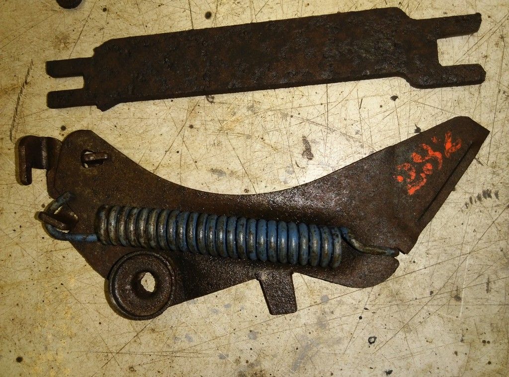

Does anyone know if this ink stamp is related to date coding?
Julian or week and year?
Has anyone else found this?

Lynn 03-15-2016 12:58 AM
Re: brake shoe adjuster dating?
I have seen quite a few. Always assumed it was the day of the year.
Jonesy 03-15-2016 07:36 PM
Me too, I think its the day of the year also. Rotors sometime have this same stamping in yellow.
HawkX66 03-16-2016 12:52 PM
I'd just about guarantee it's the day of the year. My car was final assemble August 22. My lever is stamped 232 or August 20. Here's what mine looks like.

Mr.Nickey Nova 03-16-2016 10:12 PM
Yes, the day of the year. Mine has (020) for a third week of Jan. built car.

03-17-2016 08:13 PM
Question, how do you get Aug.20 out of 232 and 3rd week of Jan. out of 020? Frank
Jonesy 03-17-2016 08:21 PM
020 = Jan 20th or the 20th day of the year
232 = August 20th or the 232nd day of the year in a non leap year.
