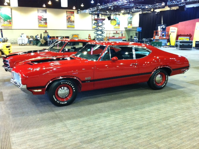

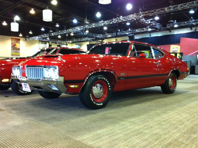

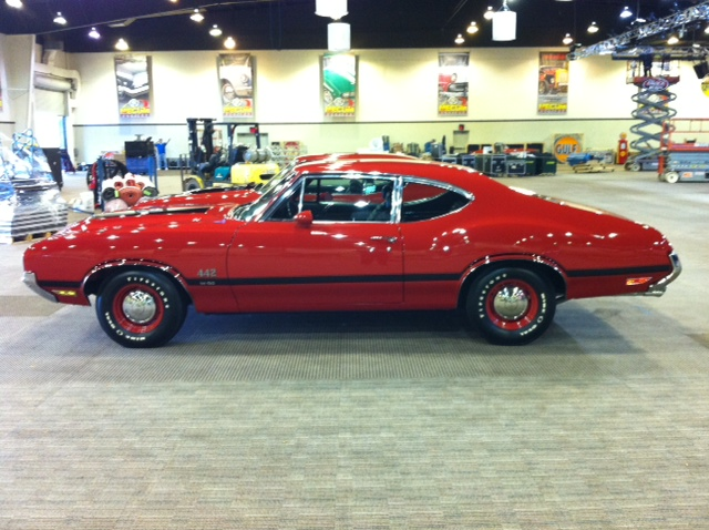

I`d go with Dog Dish [img]<<GRAEMLIN_URL>>/biggthumpup.gif[/img]
http://img.photobucket.com/albums/v6...psftsvybku.png
http://img.photobucket.com/albums/v6...psugwtp6t2.png
http://img.photobucket.com/albums/v6...psfsvjfmlp.png

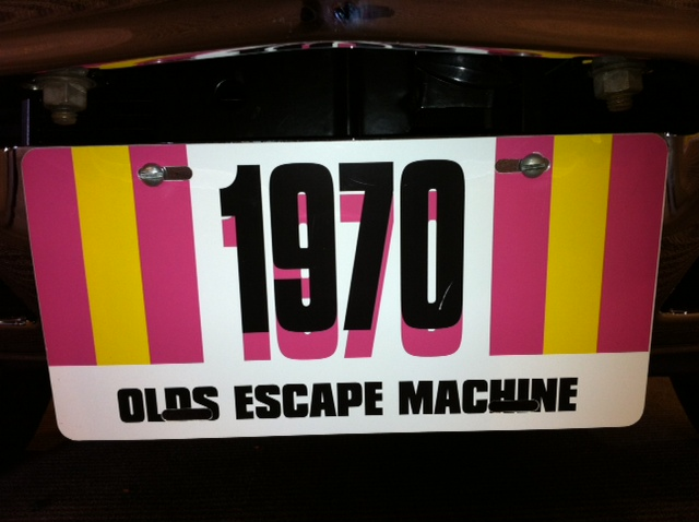

You also need this plate [img]<<GRAEMLIN_URL>>/biggthumpup.gif[/img]
http://img.photobucket.com/albums/v6...psukyywhnu.png
