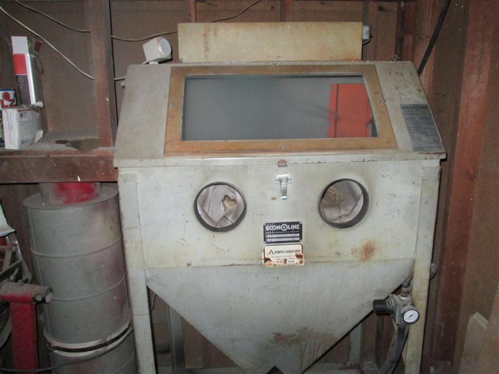

Below is a picture of my machine. These cabinets are pretty simple. The media gets poured into the blaster and is sucked up from the bottom to the gun, does its job, then drops back to the bottom again. The cycle continues....

The basic components are as follows:

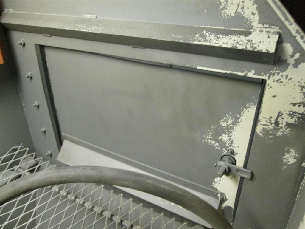

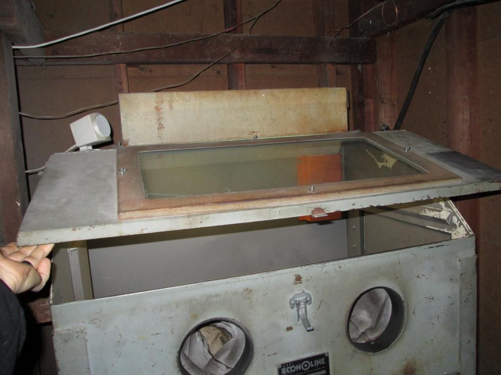

Main door:
The main door/hatch allows you to get parts in and out of the cabinet. The door has a viewing glass that needs to be cleaned often and replaced periodically due to etching. Many cabinets also have side door(s)

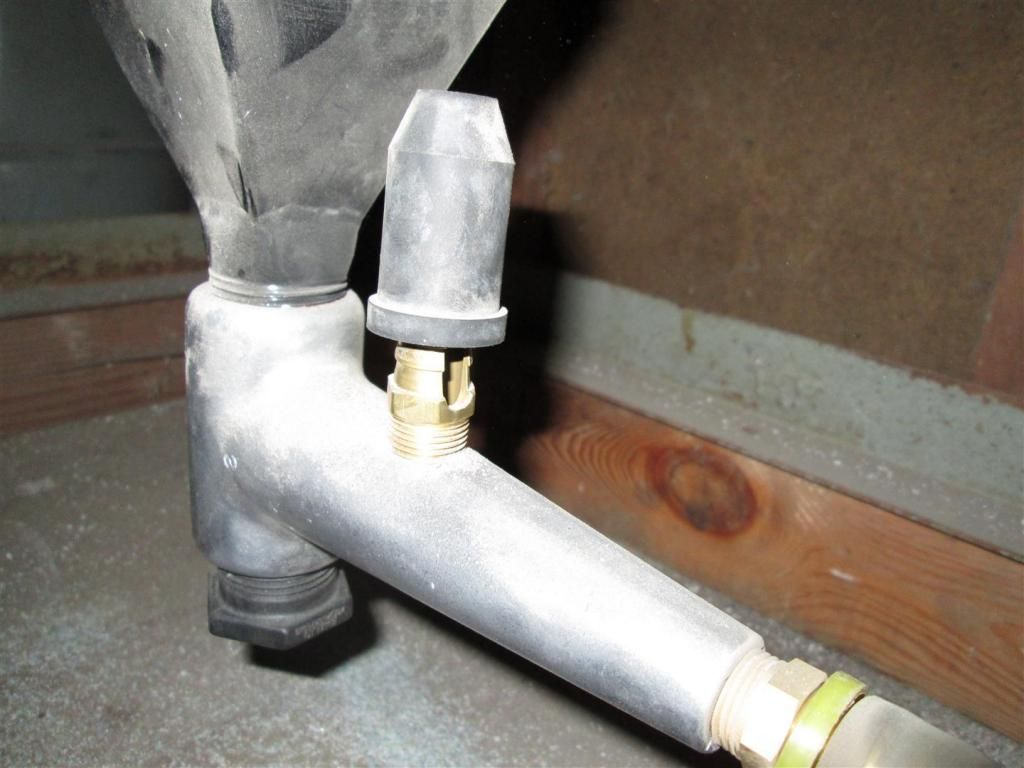

Drain:
The drain is on the bottom of the cabinet. Many cabinets have a trap door style drain. That is what this cabinet used to have. I have upgraded with a metering valve that has an air bleed to allow you to adjust the amount of media being sucked into the machine. This helps control sputtering with different types of media.
http://i179.photobucket.com/albums/w...ps2340bfaf.jpg

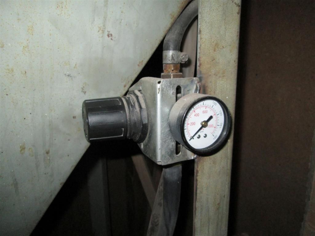

Air Control:
This regulator allows you to control the pressure of the incoming air. Pressure is a very important variable.

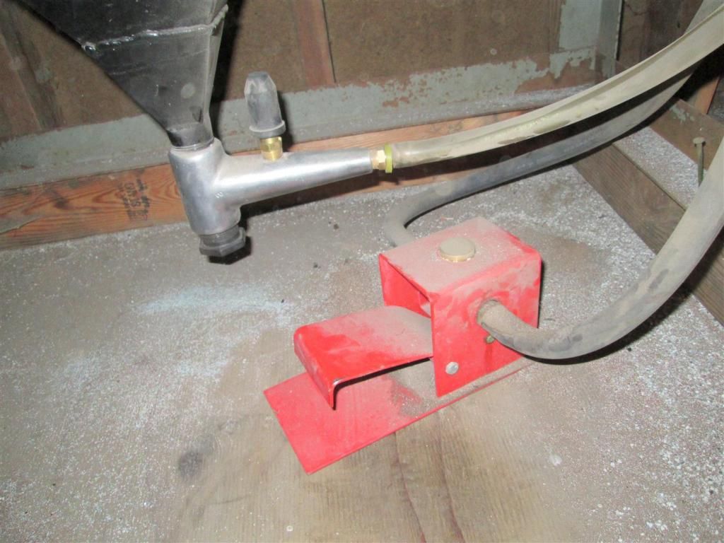

Foot control:
Much like a gas pedal, this introduces the compressed air from the compressor into the system.

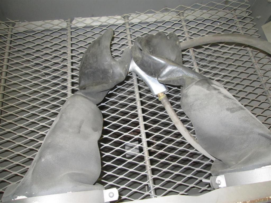

Gloves:
If you don't have these you will be a mess and your hands will hurt.
http://i179.photobucket.com/albums/w...ps2f3e8b04.jpg

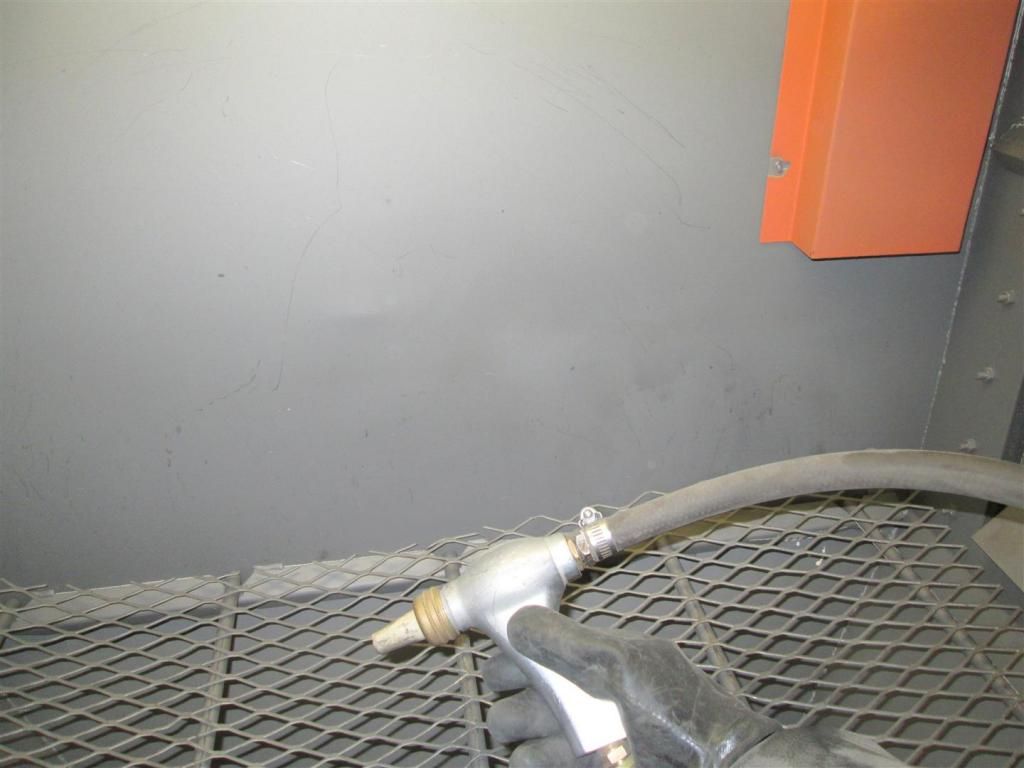

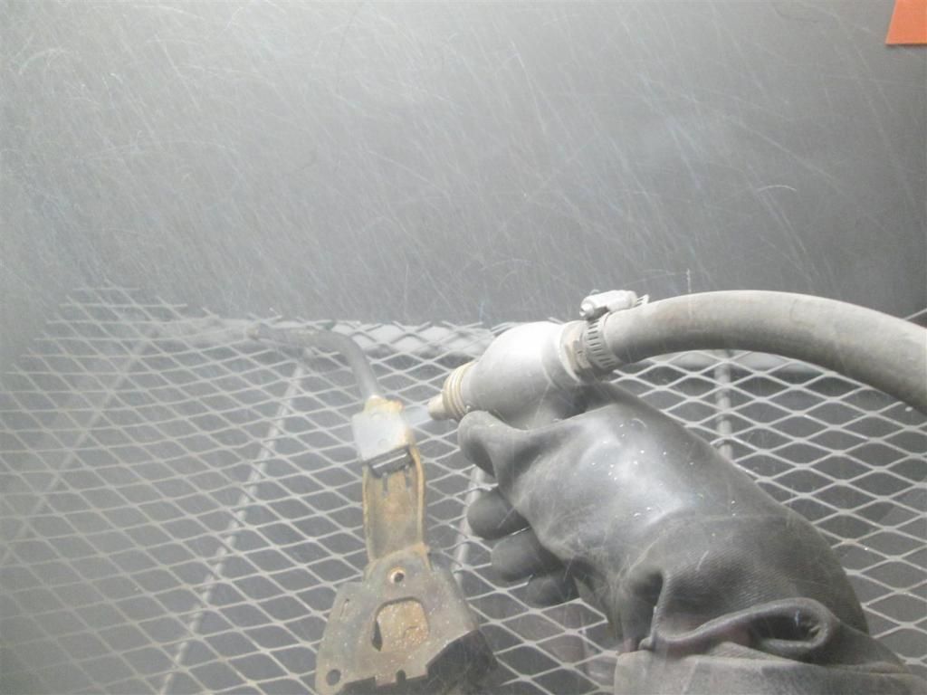

Blasting gun:
Um, this is the blasting gun
http://i179.photobucket.com/albums/w...ps191df526.jpg

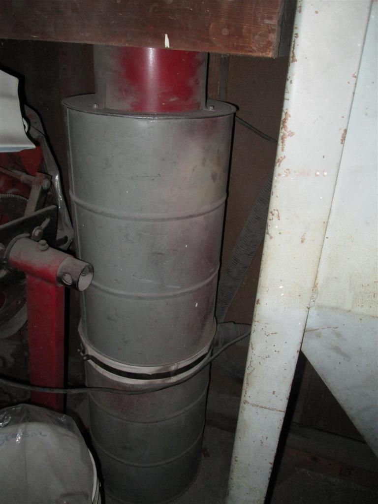

Vacuum:
All the debris being removed from the part along with media breaking down causes dust to form in the cabinet. This vacuum system removes and filters out dust. The exit from the cabinet is baffled to keep larger pieces of media from being sucked out.
http://i179.photobucket.com/albums/w...psc2fdbccf.jpg
http://i179.photobucket.com/albums/w...ps499df5cc.jpg

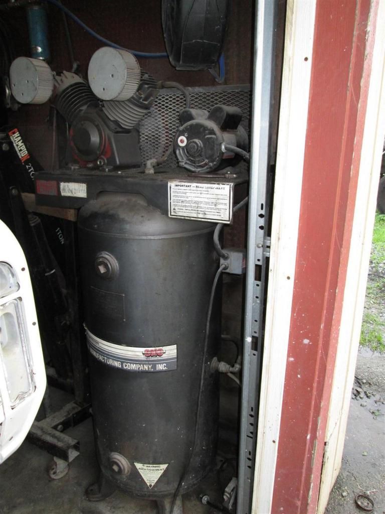

Compressor:
You need to have a fairly strong compressor to keep up with the amount of air you use but can also take breaks to let the compressor catch up if you have a smaller compressor.
http://i179.photobucket.com/albums/w...psf0f5292f.jpg

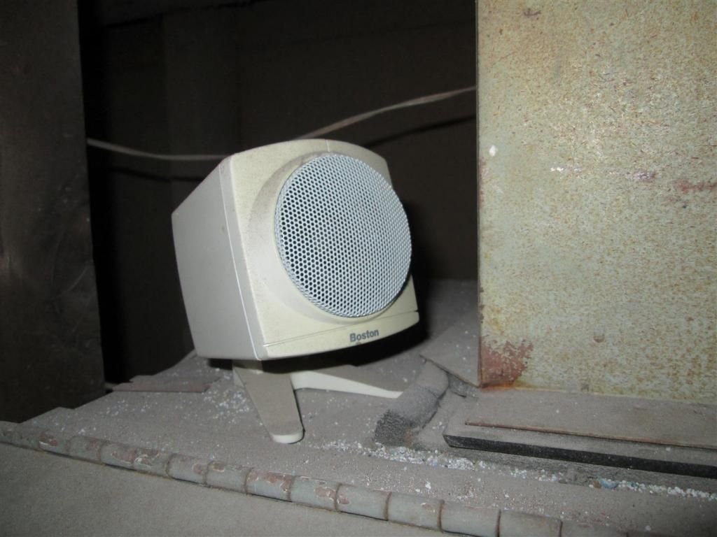

Stereo system or headphones:
This is the most important part of a blasting system. This keeps you from going insane listening to the vacuum fan and compression working their butts off, LOUDLY!
http://i179.photobucket.com/albums/w...psd72b3514.jpg

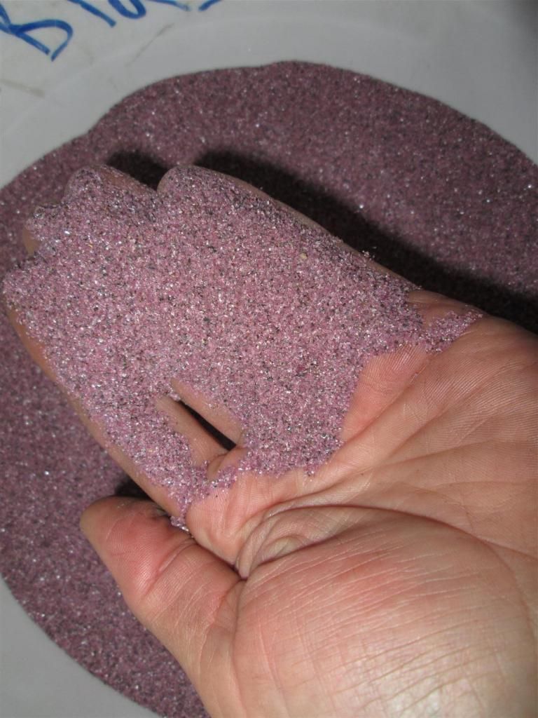

Garnet:
This media is a garnet red/magenta color. It varies from a coarse to very fine powder. Garnet is a true abrasive which will etch glass, plastic, chrome, etc. I use this media to remove rust, staining, and to clean parts to "white metal". This is a fast working media on rust, etc.

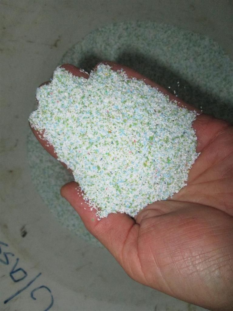

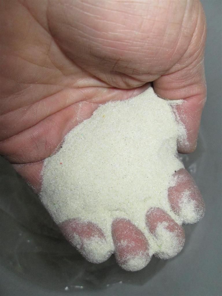

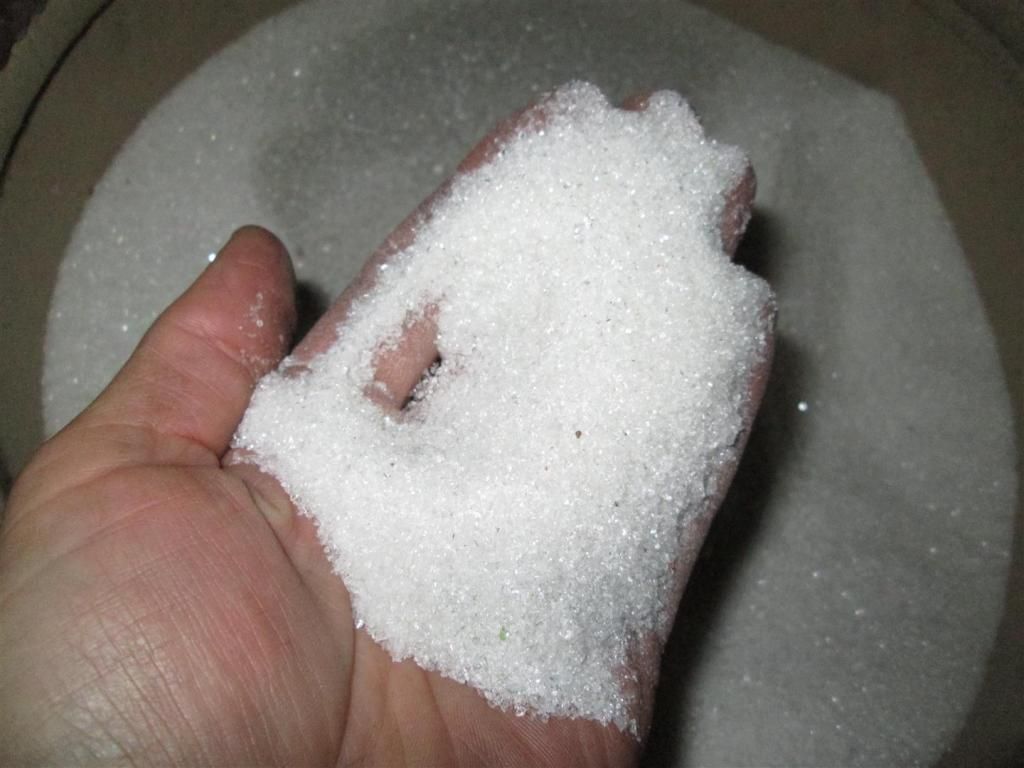

Glass bead/Glass shards:
Glass is mostly used to polish. It is a slow working media that I use on metal part too delicate for garnet. I also use this to polish pieces that have gone through the garnet process and are "white metal". The glass bead at low pressure will give a as cast appearance to aluminum and steel that has been taken to white metal. Glass shards are what you see most of the time. They are usually referred to as glass beads. They are a bit more jagged that the beads. Glass beads are very uniform and consistant in size for a more uniform finish.
http://i179.photobucket.com/albums/w...ps0b171467.jpg

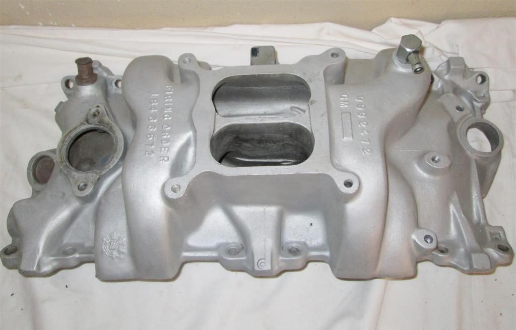

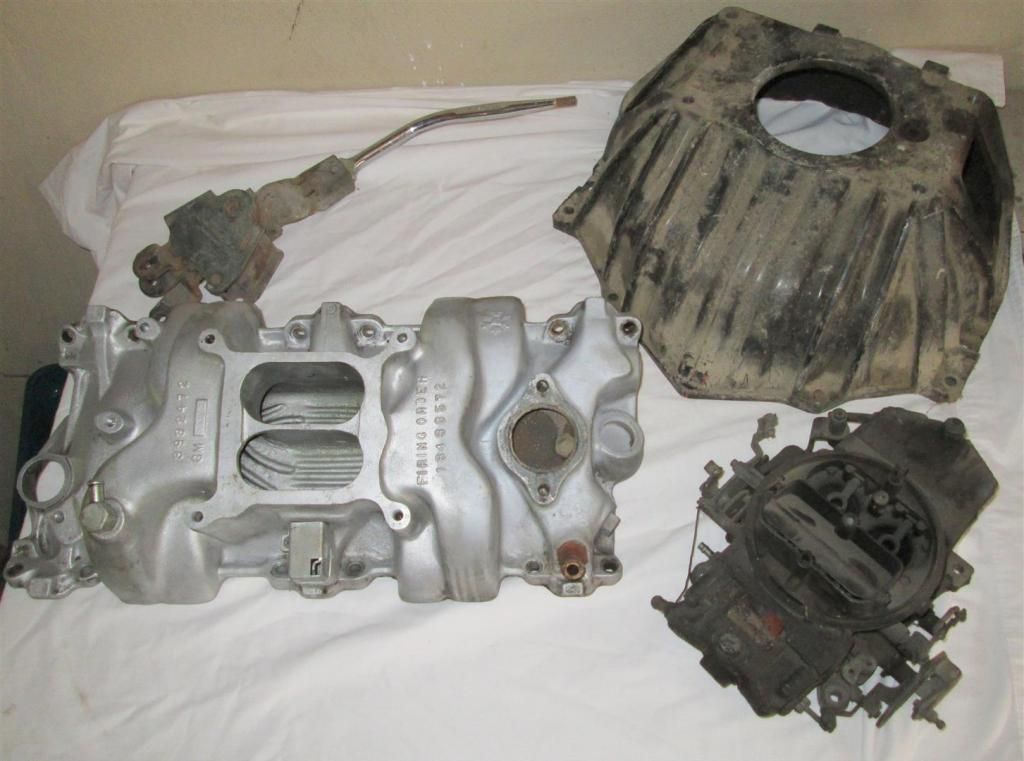

Now I'd like to show you have this media works on different automotive parts. As many of you know, I see a lot of parts on Ebay. Most times I simply want to clean the debris off so the customer can see what the actual part looks like, not the dirt and debris. I also don't want to cause harm to the part or remove any important ink stamps or markings. This is where plastic comes into play. Plastic media removes dirt and debris without altering the original finish when used at the proper pressures. It is very good at removing paint as well as long as the paint is not too thick. Plastic, like most medias does not play well with grease, silicone, etc.
I am going to show you the use of plastic media on 4 items as shown. A 1969 Camaro Z/28 intake manifold that has been painted, a 69 Camaro Hurst shifter, a 11 inch Chevy bellhousing that has been painted, and a very dirty Holley double pumper carb.

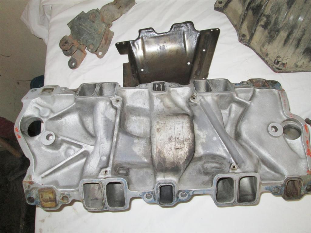

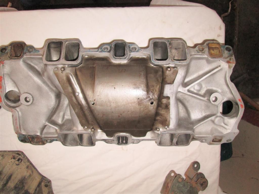

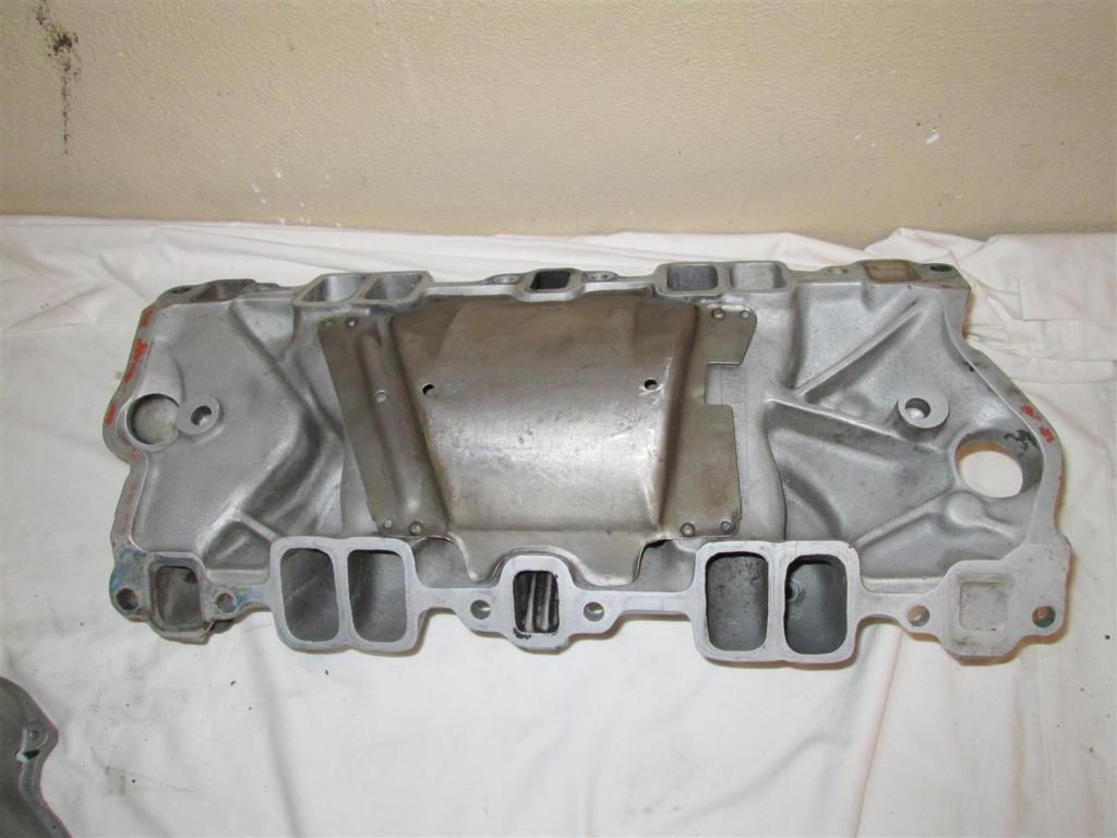

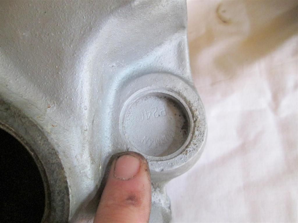

Let's start with the intake. This intake was just removed from the blown up 302 engine I show in another thread. The intake looks pretty nice at a glance but it has been painted with aluminum paint. The plan is to use the plastic to remove the paint. Then we will see what the finish other the paint looks like and decide whether the intake needs to be refinished or left as is.
http://i179.photobucket.com/albums/w...psef4a0520.jpg
http://i179.photobucket.com/albums/w...ps55eb9c06.jpg
The first step is to remove the oil splash shield from the underside. This can be accomplished with a small hammer and thin chisel of flat blade screw driver. Persuade the blade under the rivet and twist. Repeat. Many guys say that the shield can be left on with plastic since it is just plastic but I like to take them off. It also reveals the date code and since I sell these parts, many guys want to know the date code.
http://i179.photobucket.com/albums/w...ps71c452a2.jpg
http://i179.photobucket.com/albums/w...ps5925094a.jpg

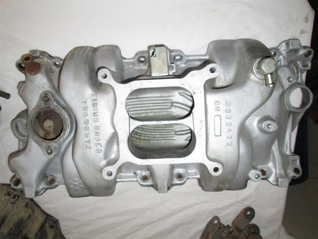

Intake after:
Its hard to see in the pictures since the intake did not look bad or too dirty originally but the intake looks great after blasting. Unfortunately, the plastic does not remove the staining on the cooling ports or water neck area. it also does not remove from from steel fittings. Most customers want a as new looking piece but I am leaving this intake as it is since it would look great on an original car.
http://i179.photobucket.com/albums/w...psb2c88e96.jpg
http://i179.photobucket.com/albums/w...ps60ad7a6c.jpg

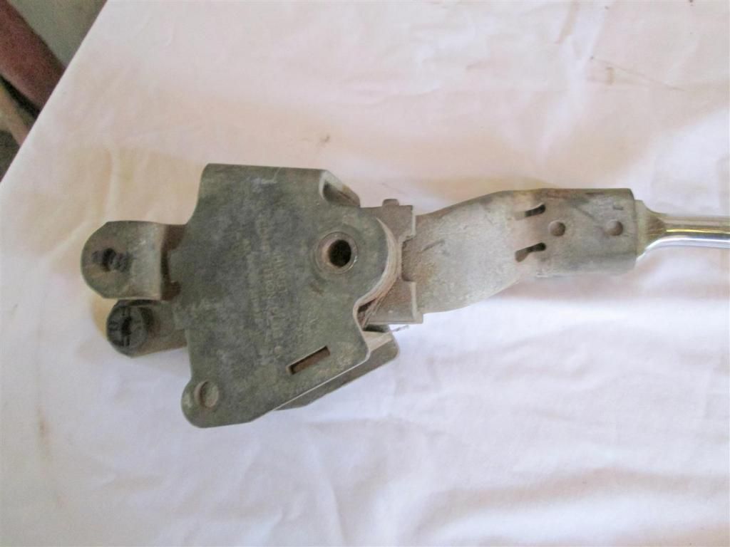

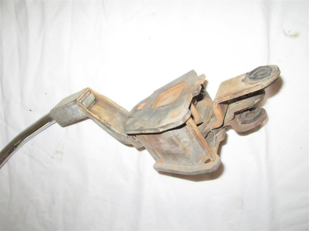

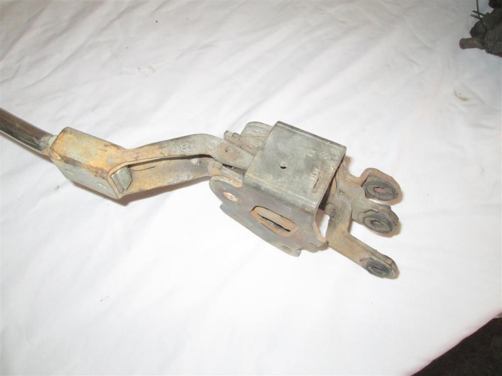

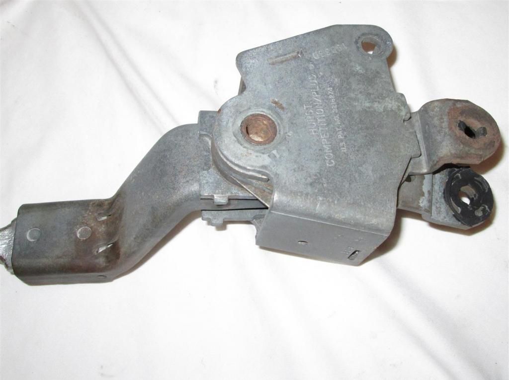

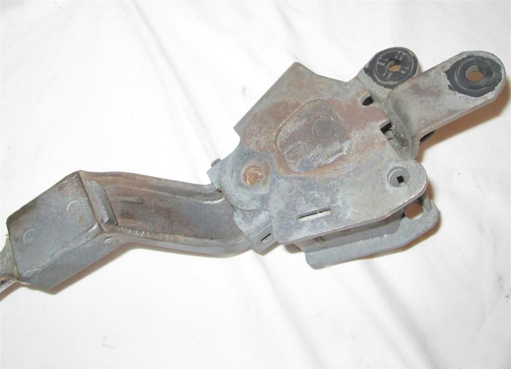

Next up is the Hurst shifter. Again, it may be tough to see in the pictures but this shifter was very dirty. The stamped numbers and letters could barely be seen and there is a calcified layer covering all steel parts.
http://i179.photobucket.com/albums/w...ps05db7a65.jpg
http://i179.photobucket.com/albums/w...ps9faa8daf.jpg
http://i179.photobucket.com/albums/w...ps20718cea.jpg
Let's get this thing in the cabinet:
http://i179.photobucket.com/albums/w...ps4623ec6f.jpg
A few minutes later:
http://i179.photobucket.com/albums/w...psd0511e69.jpg
http://i179.photobucket.com/albums/w...ps081b2542.jpg
Not too shabby! The debris is all gone and only the original plating and some surface corrosion remain. The plastic does not hard the rubber but does clean it.

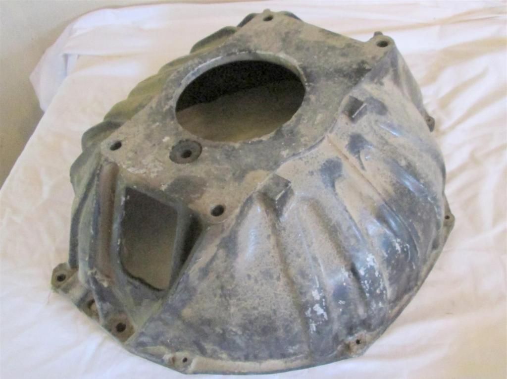

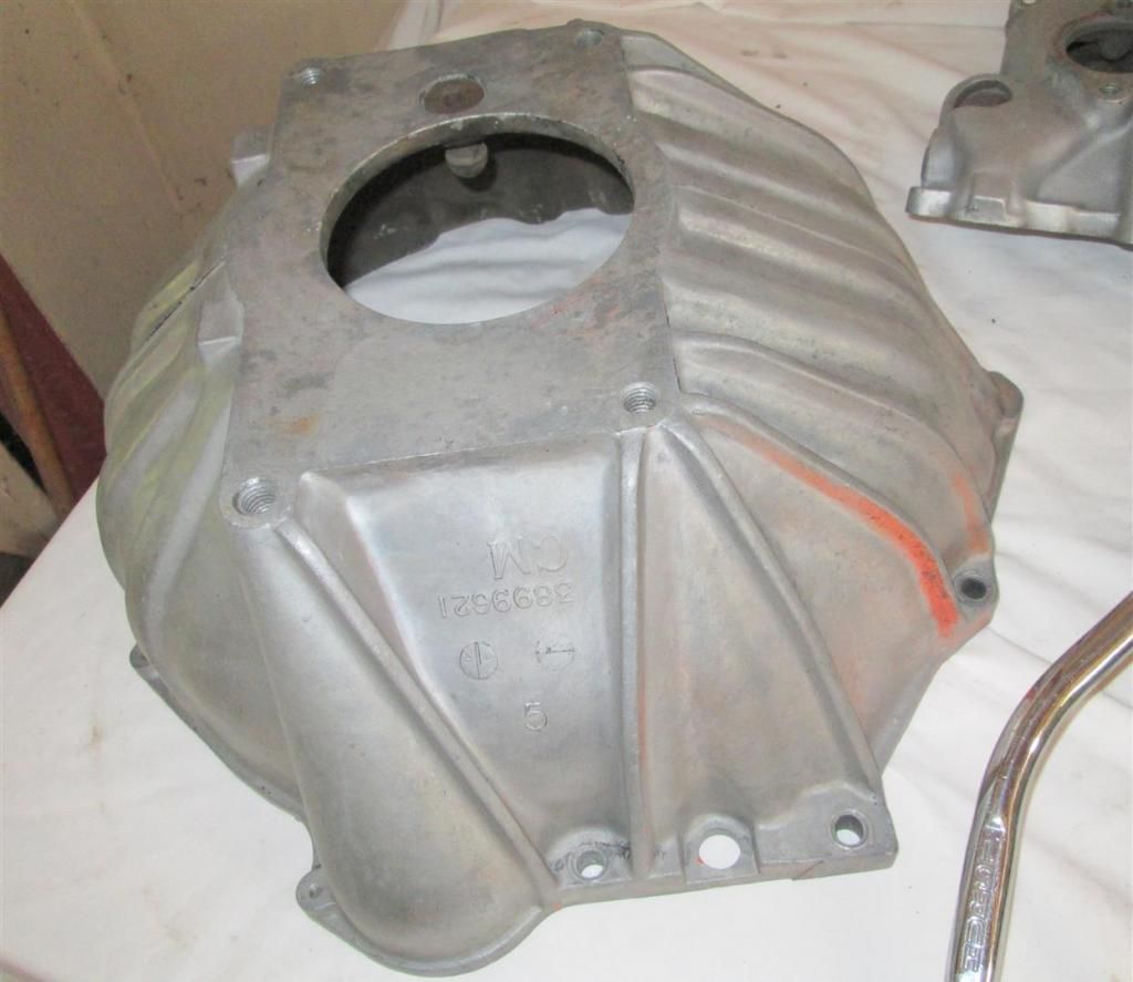

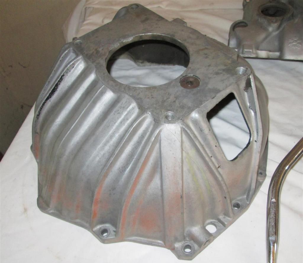

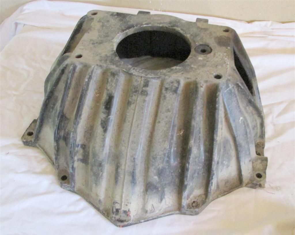

Next is the bellhousing. As I said earlier, plastic is excellent at removing paint. The outside of this bellhousing was completely blasted in 7 minutes.
Before:
http://i179.photobucket.com/albums/w...ps7f98051d.jpg
http://i179.photobucket.com/albums/w...ps8a5c3f1d.jpg
After:
http://i179.photobucket.com/albums/w...psffe208cb.jpg
http://i179.photobucket.com/albums/w...ps9ebeec83.jpg

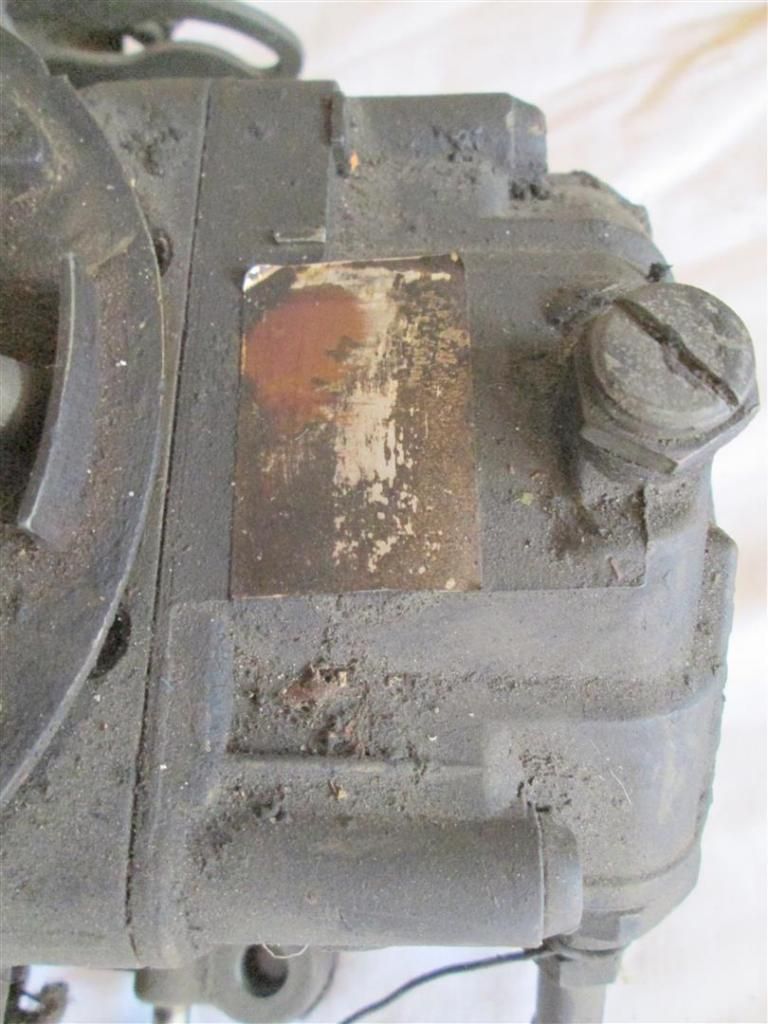

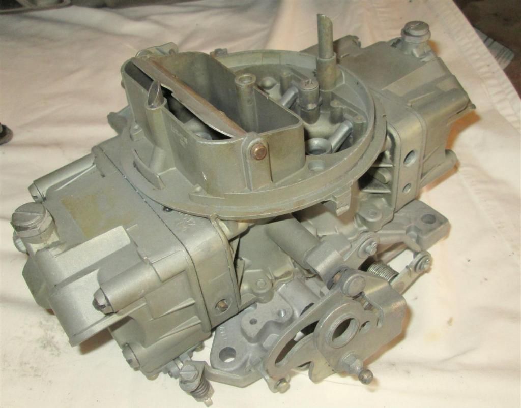

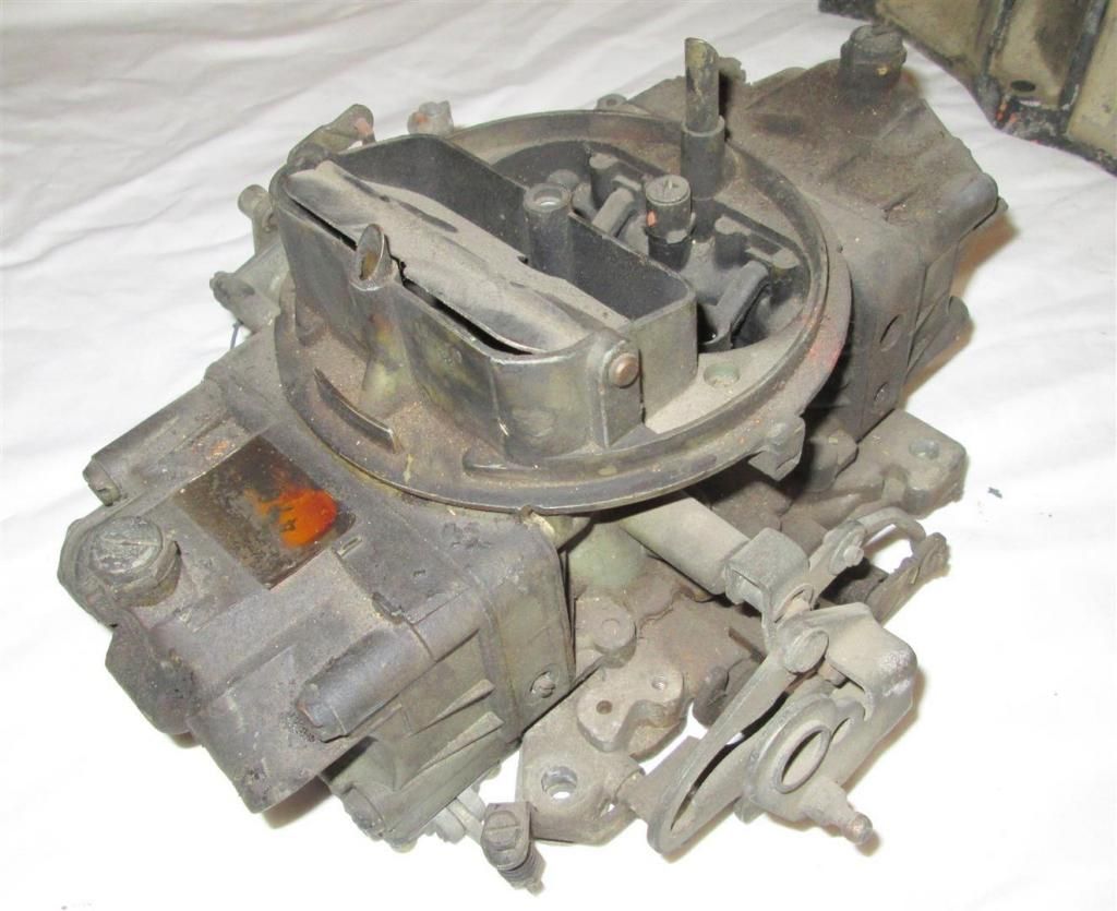

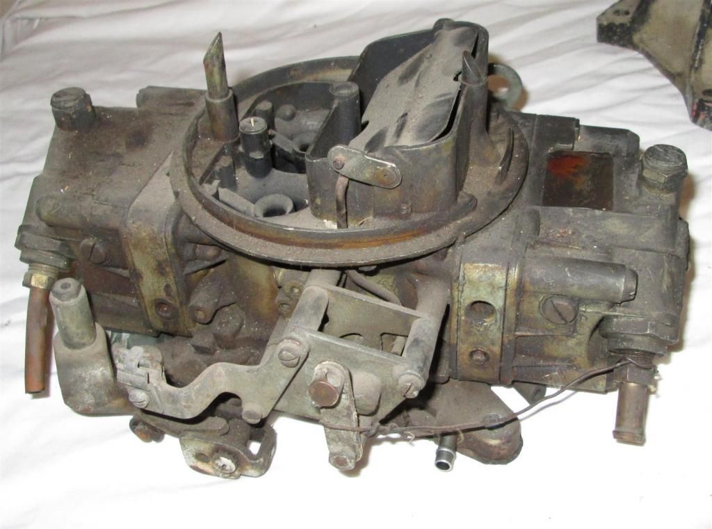

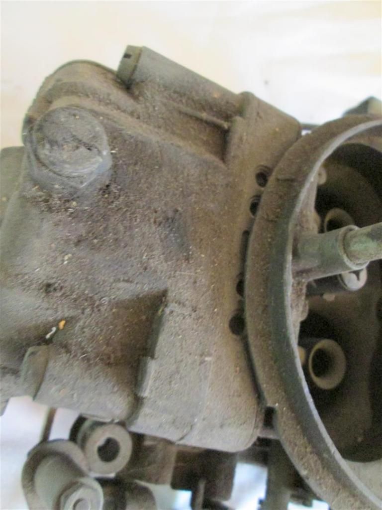

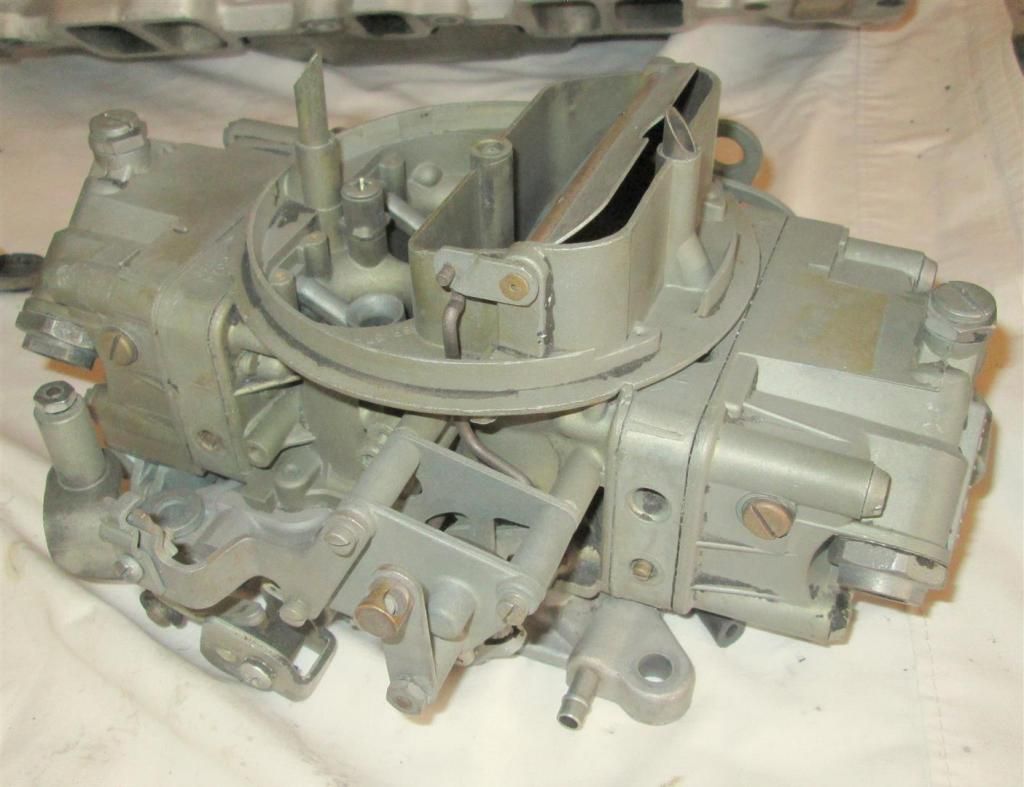

Finally, the Holley carb. Let me start by saying I did not realize how grimy this carb was when I pulled it off the shelf. I really don't know how a carb could get this nasty. Even the choke tower is covered in heavy grime. Isn't that supposed to be protected by the air cleaner?
For my own amusement and to show the limitations of the media, I decided to try blasting this carb as is. I forgot to snap any pictures of it after the initial blasting but the process can be seen in video below. I ended up having to remove much of the grease by hand so the media could actually do its job. I ended up blasting most of the grease off but not all since someone will be rebuilding this carb anyway.
Before:
http://i179.photobucket.com/albums/w...ps7a4db88d.jpg
http://i179.photobucket.com/albums/w...ps2376889a.jpg
http://i179.photobucket.com/albums/w...ps8012c1c6.jpg
http://i179.photobucket.com/albums/w...ps5442ea86.jpg
And after:
http://i179.photobucket.com/albums/w...ps03a79c7c.jpg
http://i179.photobucket.com/albums/w...psd0618acb.jpg

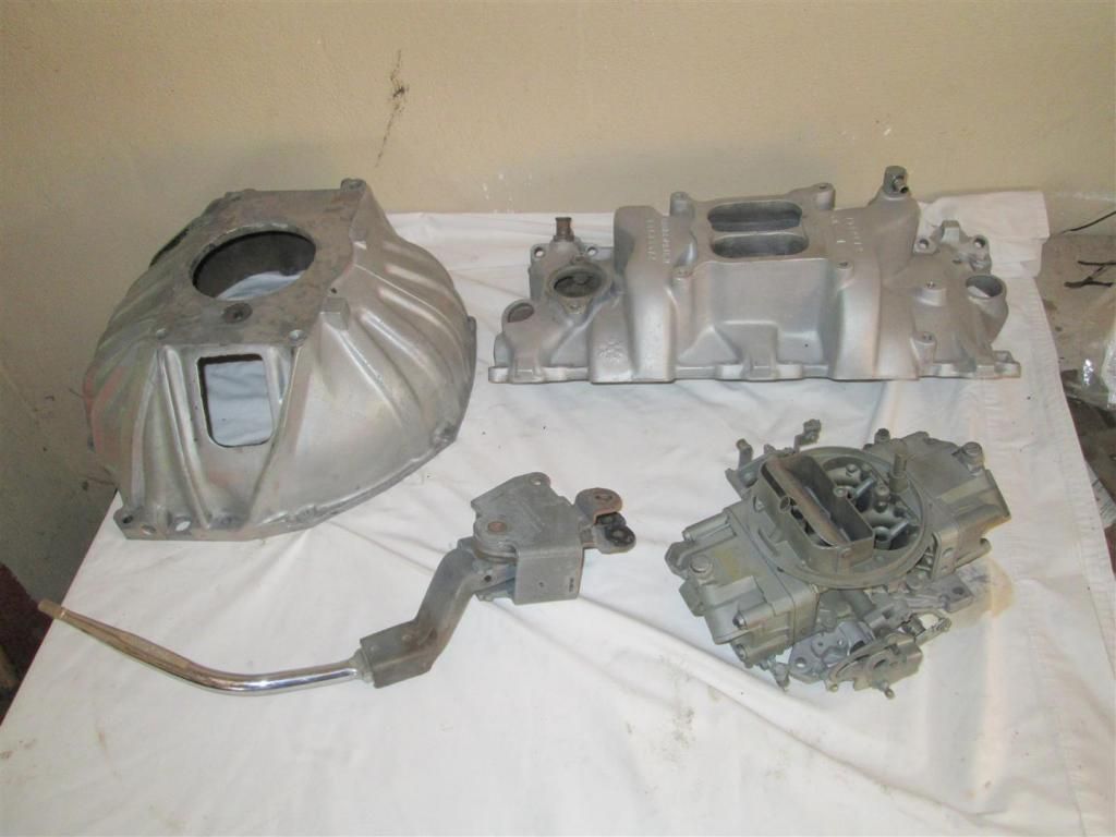

Finally, here are all 4 cleaned items:
http://i179.photobucket.com/albums/w...psf7648e9d.jpg
.....and the video:
http://vid179.photobucket.com/albums...psazguyoxj.mp4
If you guys like these before and after shots, let me know and I can take pictures while using different medias to show what they can do.
