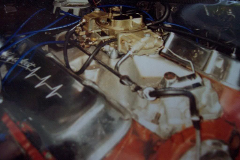

The GM HEI distributor will fit with the Weiand intakes "Team G" style like an Edelbrock Torker. I ran one of these intakes on a big block Chevy with a GM HEI distributor at one time... The intake was older however...
Hope this helps your search!!
Here is a picture....
Rich
http://i268.photobucket.com/albums/j...icture6331.jpg
