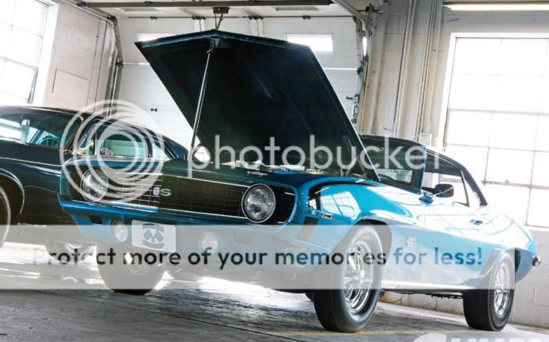

Well Vince, When I first saw your car I thought about this look here:
http://i710.photobucket.com/albums/w...psb7fb1c35.jpg

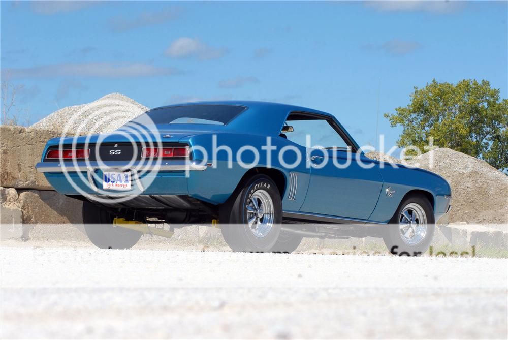

You could debate which tire is more correct, the ones above or this one here:
http://i710.photobucket.com/albums/w...ps0035ae30.jpg

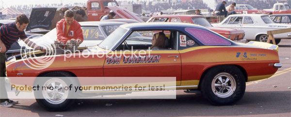

Same car, just different tires. I have seen a few vintage pics in 69 with cars still running the pie-crusts. Certainly into the 1970's the wrinkle wall is more correct (and faster)!
http://i710.photobucket.com/albums/w...psf3bd82a1.jpg
If you wan't to run a 15x8, I would get the max offset and adjust wiht spacers. I think the max is 5-3/8th offset. Mount up an L60 and enjoy the fat tire look!

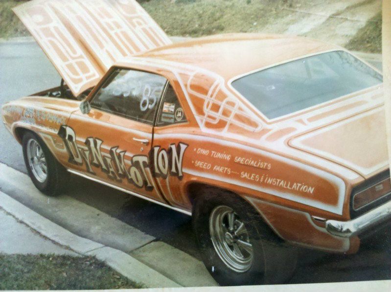

As an alternative, you can simply do a 15x7 or even a 15x6 wheel wiht the tire bulge set-up. I think Brent said his Dynomotion Camaro had 15x6 wheels in this picture.
http://i411.photobucket.com/albums/p...8_135836-1.jpg

I think I am mistaken. The two blue cars I guess are not the same.
