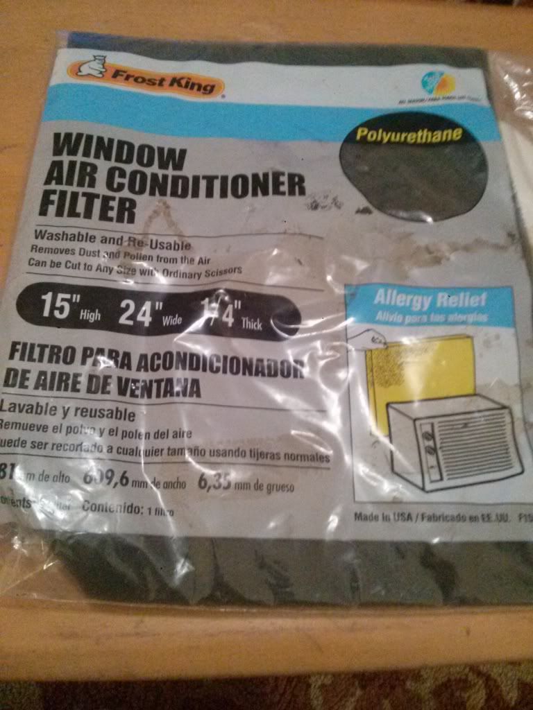

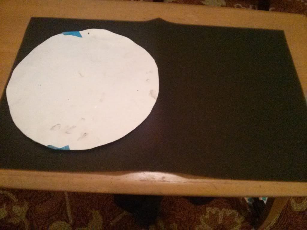

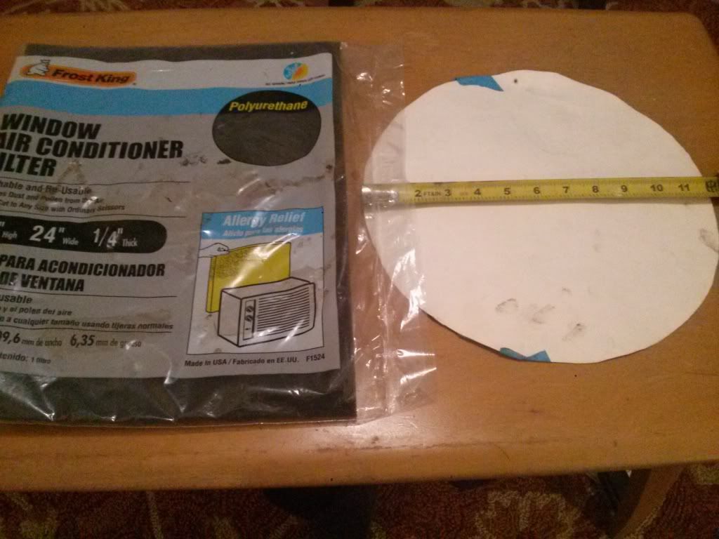

How 2 Fly Eye Air Cleaner filters for under $10
Here is my Cheap way to get 2 New Fly Eye Filters for under $10
Yes they are Fuel proof .Enjoy

I've had that material in the air cleaner on my Chevelle for a while now, and haven't had a problem yet.
Jim Ferron 09-14-2013 09:03 PM
Re: How 2 Fly Eye Air Cleaner filters for under $10
Be pretty carfull what you use for an element..I used a similar material that was intended for motorcycle use
Ran ran ok until you got on it, then it would die....super restrictive..at least for my L-88
