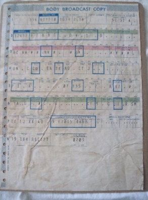

Is this clear enough for someone to tell me if it is a factory cowl hood car and where that code may be located on the sheet please? thanks in advance
http://i962.photobucket.com/albums/a...ewf/Zsheet.jpg

The photo isn't really large enough to see the sheet clearly. On my Chassis Broadcast Copy for my '69Z there is a box, #180, that says air cleaner. If it has an 07 in this box the car came with an open element air cleaner (no cowl hood). If there is a DG in this box the car came with cowl induction. Hope this helps.

Camaros built with ZL2 as an option have the code stamped on the BBC just under the Zone & dealer info at the bottom left. A Z/28 would have 5ZL2AA there.
COPOs don't have it because ZL2 was included. They would have, for example, 9561AA.

Box 86 (next to the Y55 battery) is 07, open element - flat hood.
Interesting that the body # is blank. ??
Going thru the sheet, I see some possible problems. I'd like to see a clearer copy of the sheet before I call foul, but I'll call suspect....

----I can see why you find the hood suspect as the wire up to the flapper is MIA in the pics. Makes one wonder.......Bill S

duct hoods were late, late December of 68 options I believe. The car in question has a duct hood on it Des so you are in.
