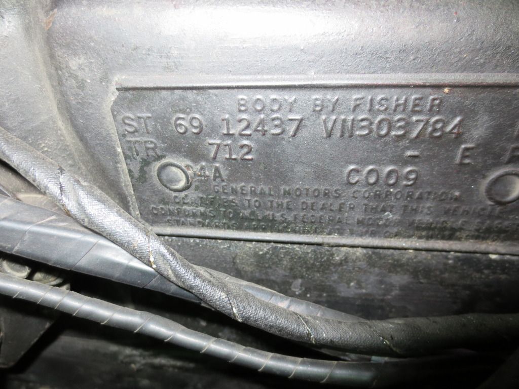

Where did you get a pic of the trim tag? I don't see one on the auction listing.
If I were selling a true original car with the original motor and trans, I would be darn sure to post clear pics of the pad stamp and partial vin stamps.

thanks Lynn [img]<<GRAEMLIN_URL>>/beers.gif[/img]
I asked the guy to email me a pic of the trim tag and he did so.

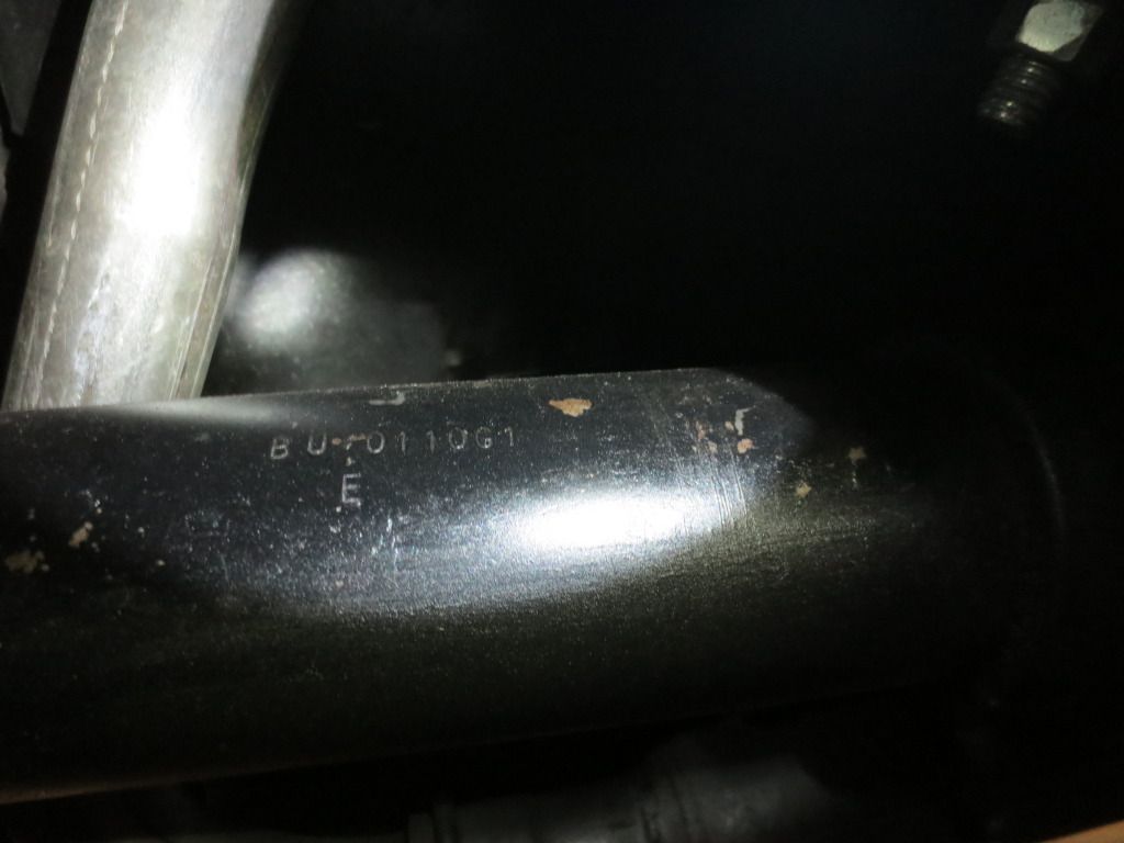

http://i962.photobucket.com/albums/a...f/IMG_0662.jpg
http://i962.photobucket.com/albums/a...f/IMG_0663.jpg

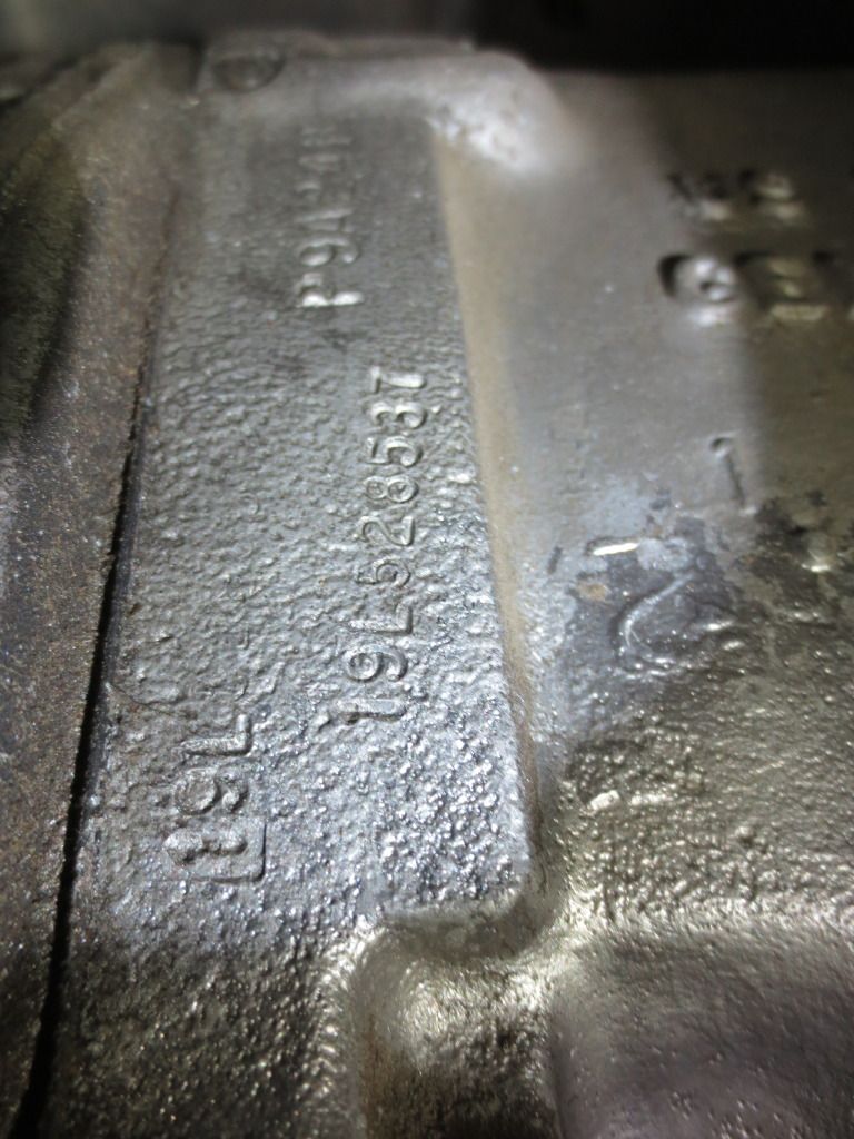

http://i962.photobucket.com/albums/a...f/IMG_0562.jpg
Tracker1 10-02-2012 01:46 PM
Re: '69 Z28 EBAY
not loving the DZ stamping - looks like it has serifs?
firstgenaddict 10-02-2012 01:57 PM
Re: '69 Z28 EBAY
Does it look like the deck was cut lightly? but preserved the stamp?
Tracker1 10-02-2012 02:03 PM
Re: '69 Z28 EBAY
<div class="ubbcode-block"><div class="ubbcode-header">Originally Posted By: firstgenaddict</div><div class="ubbcode-body">Does it look like the deck was cut lightly? but preserved the stamp? </div></div>
yeah over about as far as the DZ and date - thanks firstgen
unless someone will vouch for the stamping as a legit looking LA stamping...is it an SS350 Los Angeles car, 327 car perhaps? i am a bit put off...anybody else?
