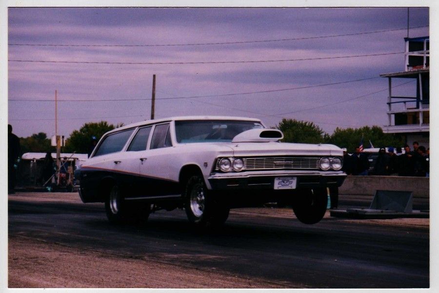

Rixls6 09-21-2012 01:06 PM
Re: Best oval-port head
<div class="ubbcode-block"><div class="ubbcode-header">Originally Posted By: scuncio</div><div class="ubbcode-body">No need for AFR heads...the open chamber oval ports will support 600hp. </div></div>
Agreed. I had a 468 in a 66 Chevelle wagon that ran consistent 10.80 with a pair of 049's and a flat tappet cam.
http://i36.photobucket.com/albums/e4...ps473bf98a.jpg

10.80 GM Long Roof [img]<<GRAEMLIN_URL>>/biggthumpup.gif[/img]
