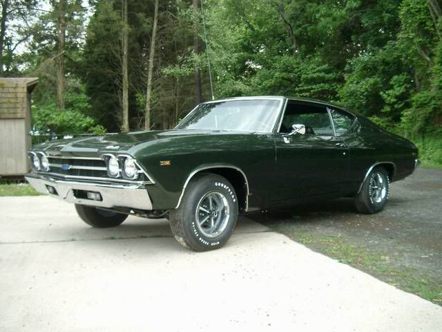

Alss 08-12-2012 10:57 PM
Re: 69 Chevrolet Goodyear Tires
I iused the wide tread goodyears;
http://i518.photobucket.com/albums/u.../IMGP29591.jpg
