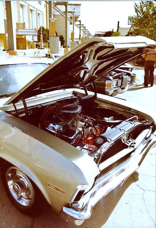

Xplantdad 12-02-2011 03:53 AM
Re: Day 2 Intake
<div class="ubbcode-block"><div class="ubbcode-header">Originally Posted By: SeattleCarGuy</div><div class="ubbcode-body">I used an oval-port Torker on my '67 Camaro back in the 80's. I loved the way the big Holley carb sat an angle. Great intake for power all the way up to around 6700 rpm where I shifted at. </div></div>
Yep...same one that was on my Nova....Edelbrock Torker 2-0
http://img.photobucket.com/albums/v6.../tn_smnpo2.jpg
http://s3.racingjunk.com/ui/2/81/233...-torker-20.jpg
PxTx 12-02-2011 04:02 AM
Re: Day 2 Intake
About time we had a pic posted in the thread. Thanks Bruce!
An old TM20 in racing junk right now:
http://www.racingjunk.com/Intake-man...-0-Intake.html
