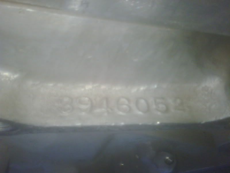

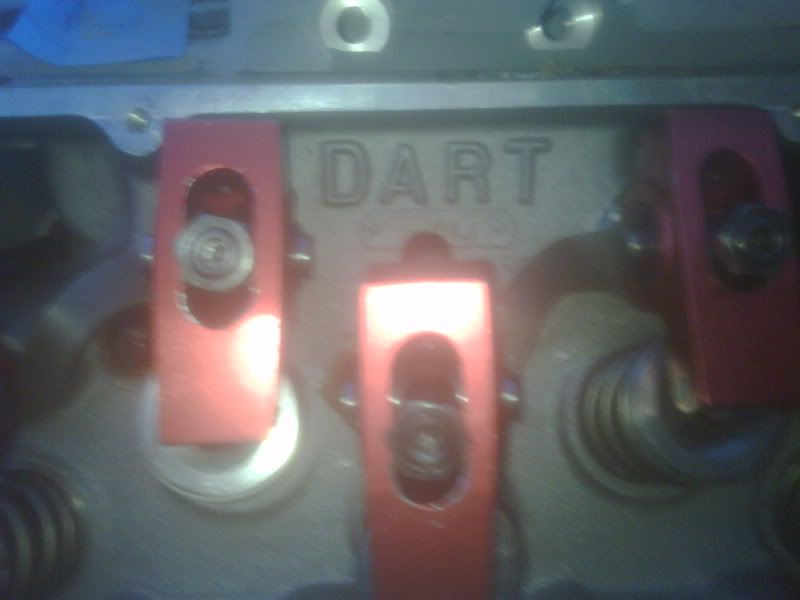

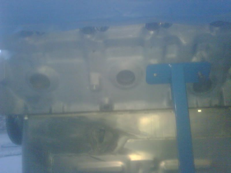

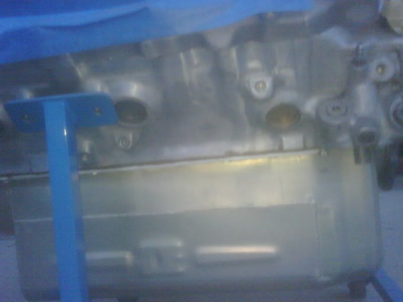

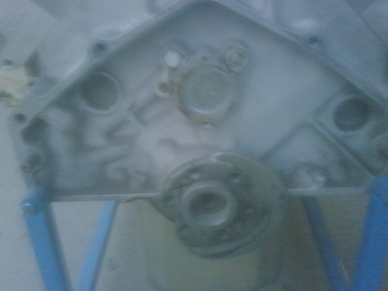

I was supposed to get a 69 ZL-1 motor last weekend, but shipment got delayed for 2-3 weeks. Any opinions welcome if something looks odd on the block surfaces as I bought this without personally inspecting it.
I get the long block, less blower intake. I get a ZL-1 intake that has been with the motor.
I am sitting here biting my nails....

SuperNovaSS 05-06-2011 08:20 AM
Re: 69 ZL-1 motor (opinions)
Looks like a later cast block with the press in freeze plugs. Also looks stroked to at least 454 with the extra balancing weight added to the crank flange.

black69 05-06-2011 08:34 AM
<div class="ubbcode-block"><div class="ubbcode-header">Originally Posted By: SuperNovaSS</div><div class="ubbcode-body">Looks like a later cast block with the press in freeze plugs. Also looks stroked to at least 454 with the extra balancing weight added to the crank flange.
Jason</div></div>
It has a 'hank the crank' in it if that means anything on the external weights, I thought it was a 427 stroke crank, either way its ok, I get the paperwork on the rebuild when it gets here. It also has some type of head bolt that goes deeper into the block. A lot of money was spent on the heads too. It was never fired. 11:1.
