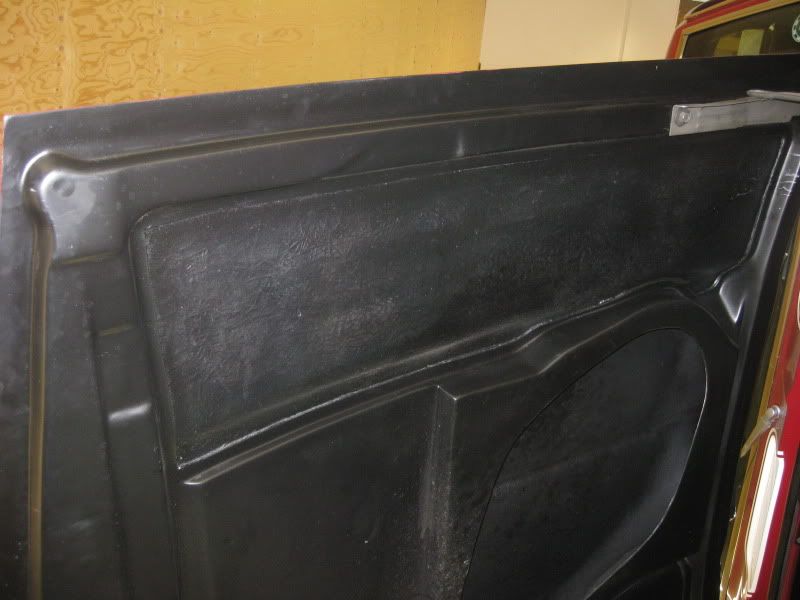

Hi Guys,
I was wondering if someone could verify the originality of this cross ram hood. It is on a good friends 69 Z28. We both believe it to be original but would like the input of "the experts".
All the best,
Dave

92646 12-14-2010 05:30 PM
Re: Original Cross Ram Fiberglass Hood?
I thought the original factory fiberglass crossram hoods came drilled for hood pins from the factory?
Enoch 12-15-2010 01:02 AM
Dave,
its bogus. I can point out 10-15 differences if need be but this is a repro for sure. Just think of looking at a 69 corvette hood and looking for press moulded parts as well as the fine raised hair texture you normaly look for on a real corvette hood. The repro hoods are hand laid and have lost many of the original detsil items that originals have. With time a repro hood could be maid to look very close to an original.
Hope this helps, Rich
