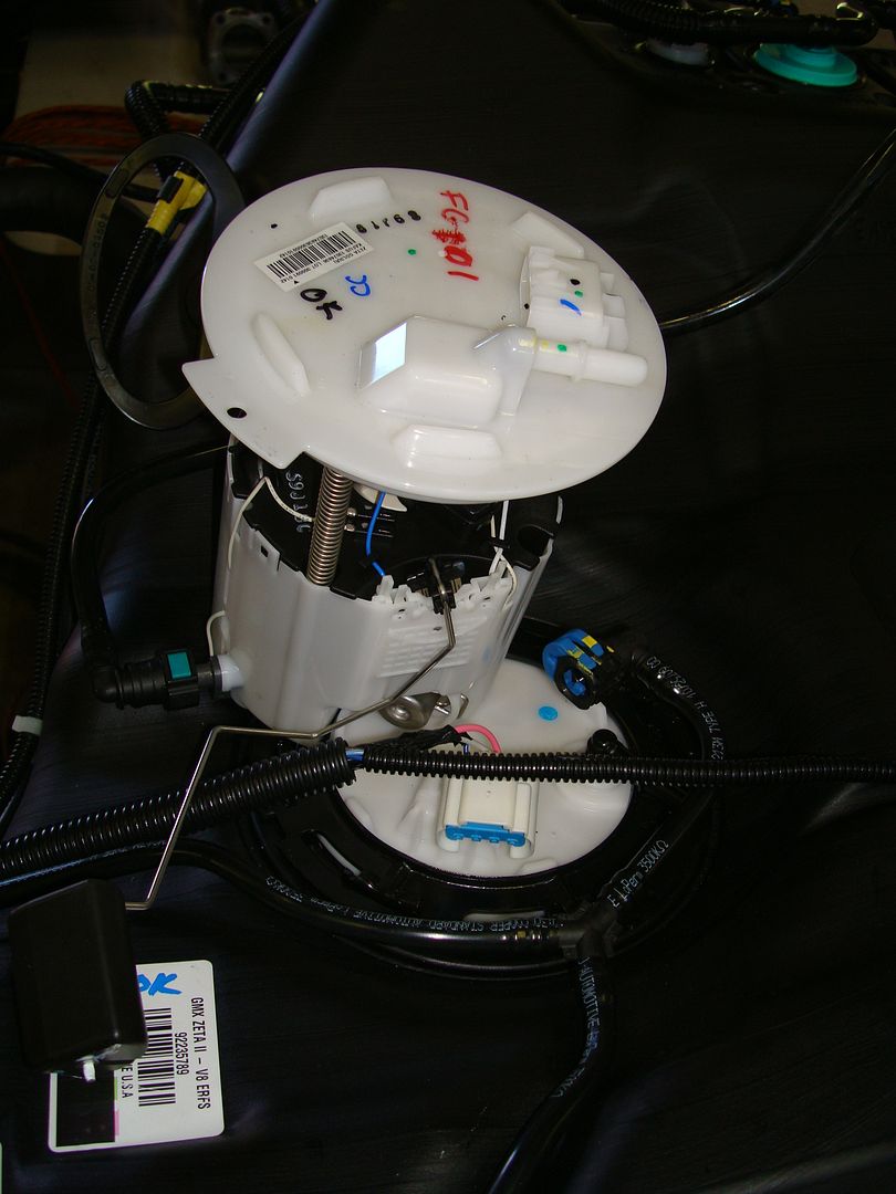

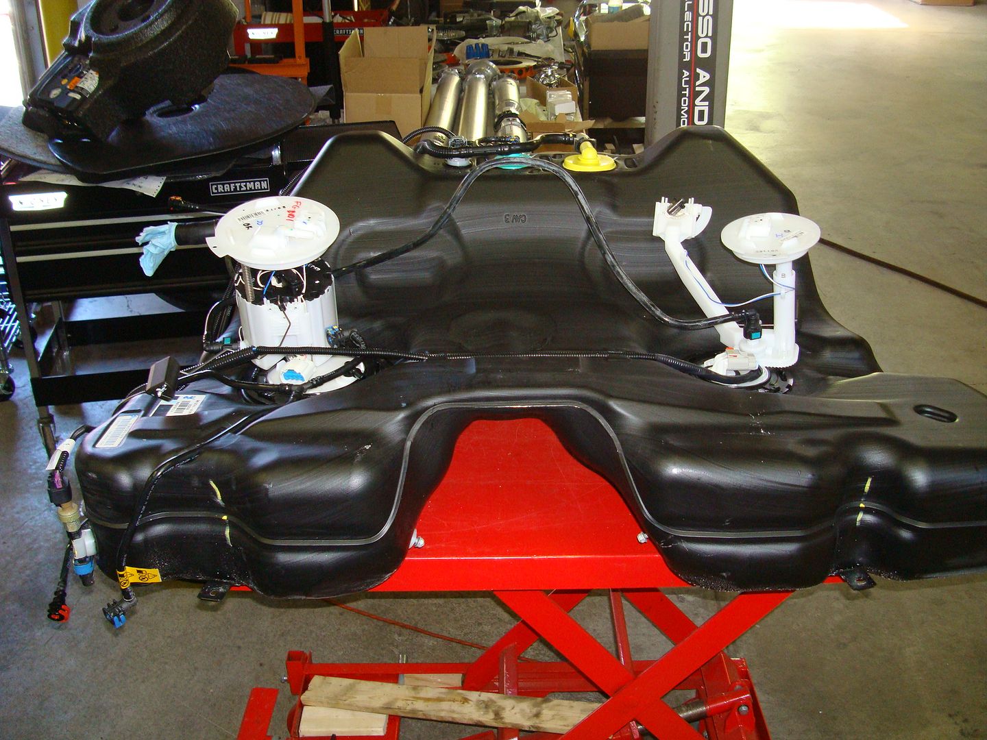

Big HP needs an upgraded fuel system. We use a "deuce" double custom made pump for 650rwhp up to approx. 900rwhp and a tripple for 1,000rwhp or more.
(Yes, we have a Nickey Camaro, work in progress which will produce more than 1,000 hp to the rear wheels, which will be able to be used as a daily driver.)
We have to add a different computer control module for the pumps as well as a special upgraded wiring harness.
[img:center]http://i9.photobucket.com/albums/a79...01parts001.jpg[/img] [img:center]http://i9.photobucket.com/albums/a79...01parts002.jpg[/img] [img:center]http://i9.photobucket.com/albums/a79...01parts003.jpg[/img] [img:center]http://i9.photobucket.com/albums/a79...01parts011.jpg[/img]
