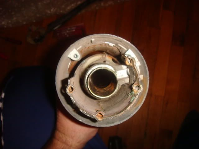

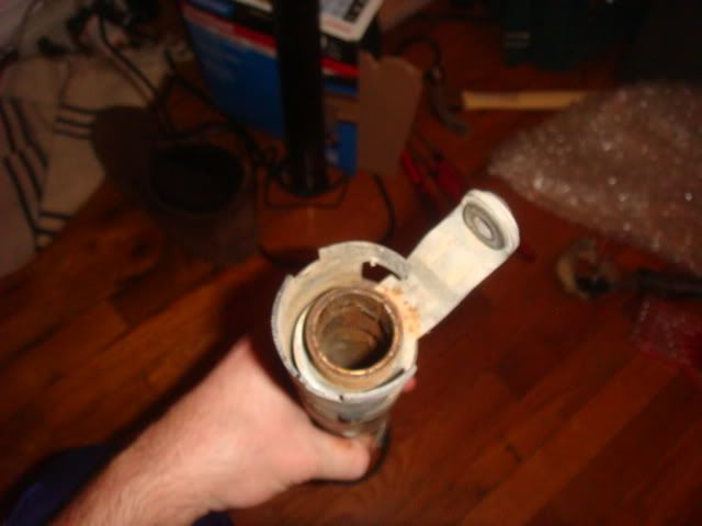

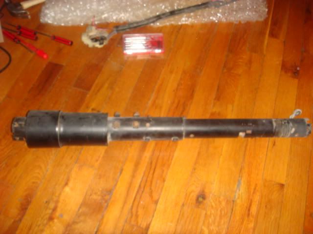

This is a floor shift column for my '69 Biscayne. I have it completely disassembled aside from the column shaft tube and cover. I can't figure out how to get it apart. I'm seeing no rings, bolds, nothing. It's a little different from the rebuild 'how-to' articles I've seen, so I'm stuck.
Any ideas?
Here's some pics of what I'm looking at.
http://i256.photobucket.com/albums/h...R/DSC01604.jpg
http://i256.photobucket.com/albums/h...R/DSC01605.jpg
http://i256.photobucket.com/albums/h...R/DSC01607.jpg
https://www.yenko.net/ubbthreads/imag...lins/dunno.gif
SS427 02-23-2010 06:18 PM
Re: steering column restoration
It is likely that your inner steel tube is corroded and stuck in the aluminum inner housing near the top of the column. I have had this happen numerous times and am usually successfull giving it some friendly taps and driving it off after spraying some Cryoil down inside. You have to be carefull as you can easily bend the bottom portion of the outer housing. You can also carefully try using some heat on the inner shaft near the top. Good luck

69Tom 02-24-2010 05:08 AM
Rick, thanks a ton. That did the trick. It wasn't rusted, however, but in there with some kind of epoxy maybe? In any event, I wonder what they put in there for it to stay in place like that. Just curious what you have done, as not only do I want it to stay in place, but I will also have to drive it back in place (if epoxy is used) and need to get it in the steering shroud correctly.
