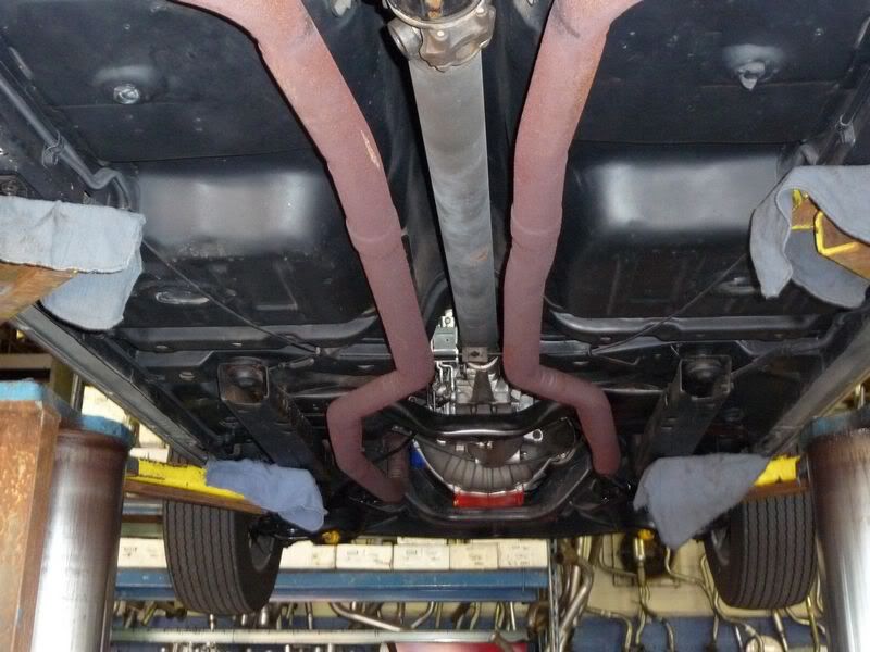

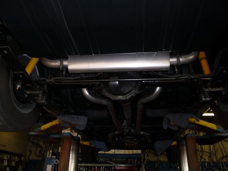

You will be very happy with the Gardner. If you want it to look like factory, have it welded like the factory did it. Gardner will need to know ahead of time which way you will be installing....if you use clamps, they will slit the pipes so they go together easier but if you weld, they don't slit the pipes and they fit tighter when you slide the two pieces together. Here are before and after pics of my Gardner system installed on a 70 Z28. I chose to have mine welded like the factory did it.
