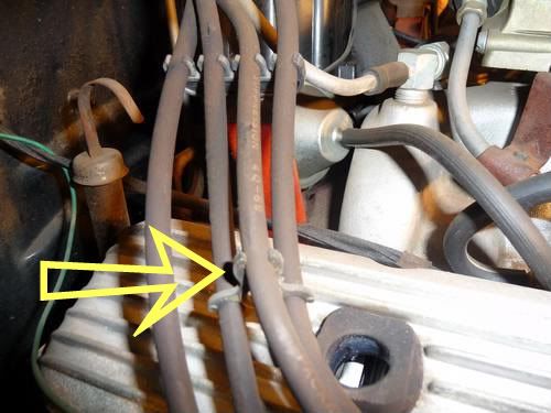

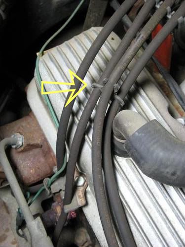

mockingbird812 04-02-2009 10:19 PM
Re: SB wire separators (3 wire disc type)
Here are a couple of photos of Charley's 1100 mile '70 Z. Would these separators be correct for a '70 Deuce?
http://img.photobucket.com/albums/v6...eSeparator.jpg
http://img.photobucket.com/albums/v6...Separators.jpg
Thanks Charley! https://www.yenko.net/ubbthreads/imag...lins/beers.gif
