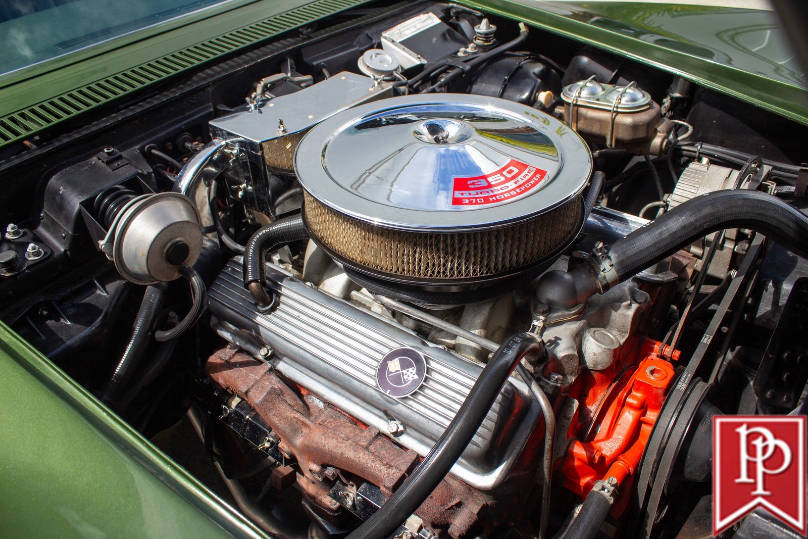

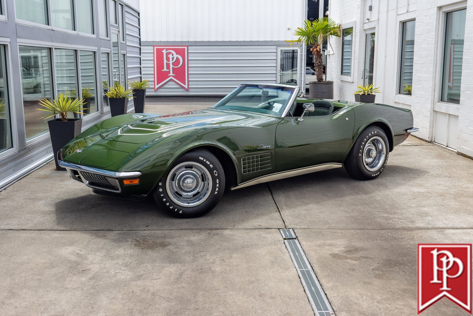

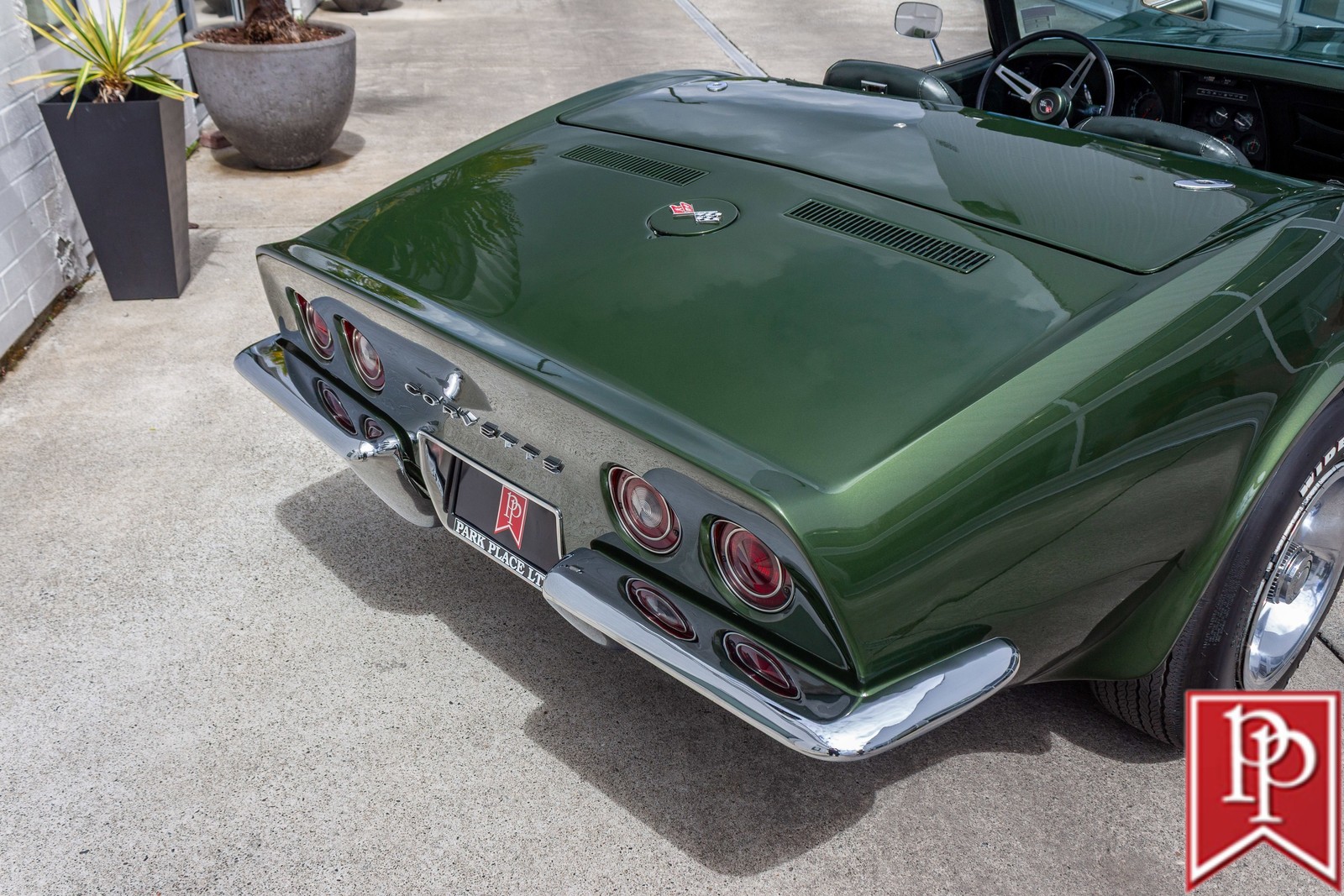

Still waiting for these incredible '70 LT-1 Corvettes to hit their stride in value. Seller claims only 1278 were produced in '70 - is that correct? Probably a $100k car in a few years.

That is a pretty car, but the pictures are all glamor shots. No pictures of tags, engine stamp, chassis, or paperwork (if available). You really can't come close to a buying decision with what they posted.

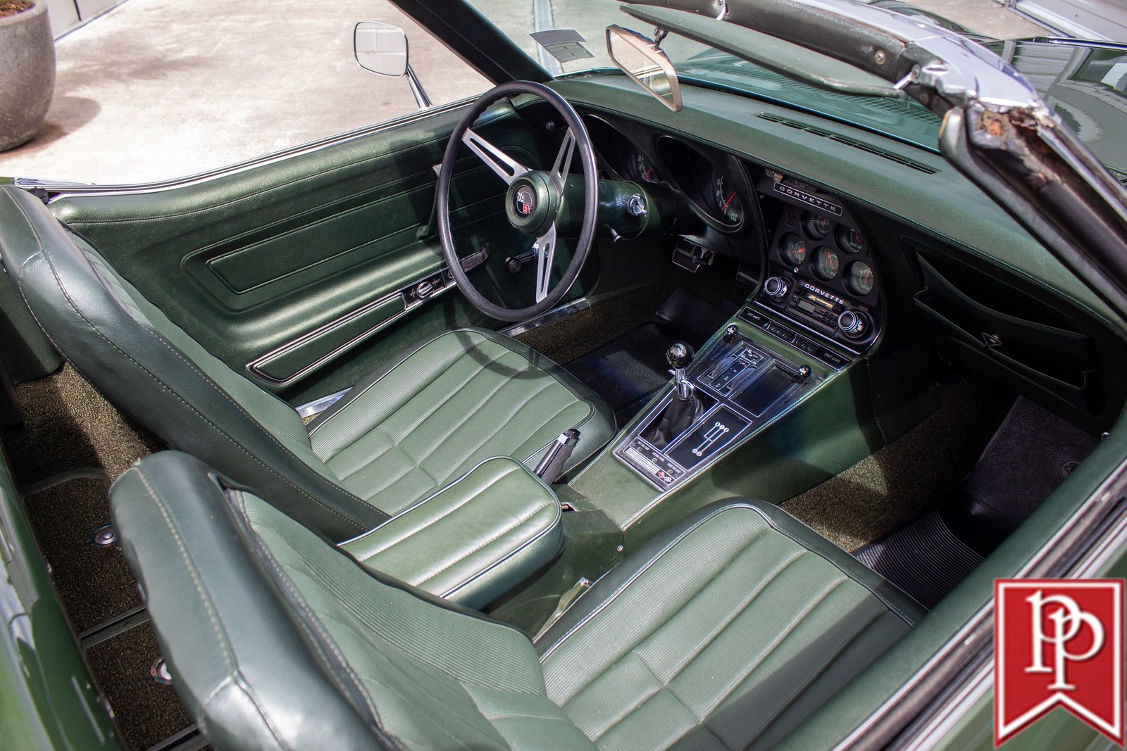

----This good looking 70 LT1 appears to be a pretty decent 70 LT1. As I type this I'm hoping there's a buyer out there that loves a green on green color combo. That's a hard hump to overcome....Bill S
scuncio 08-29-2025 11:31 PM
Totally agree. Growing up in WI nearly every older vehicle was green on green, some even triple green. It’s growing on me….

I can't agree more. That's a hump I just don't see me ever getting over with a Corvette, Camaro, or a Chevelle. Having the upgraded custom interior option that might make it an easier pill to swallow. Bill
LT1vette 08-30-2025 01:56 AM
I'm going to stick my neck out and say...The green exterior was common, but the green interior is not, especially on an LT1.

----That would have been a great upgrade, but green deluxe interior was not available in 1970. To Bad! Saddle with the deluxe interior would have been a knockout....Bill S
