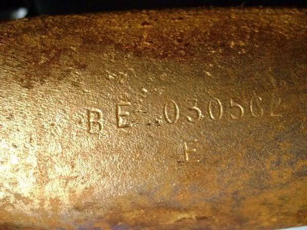

1968 Camaro that is a project, I’ve had this car sitting for a couple of years now. I have no paper work to know what this car is for sure. It has RS components and Z/28 badges. Front disk, 6000 red line tach, 15in tire pressure sicker on glove box, motor and trans are missing. Car has a big block heater core. But it’s the 12 bolt that’s in the car stamped BE 0305G2

Get the cast date code off, Im still new on finding the history on "BE" rears, I have been told they are COPO specific, My 68 had a real late 68 or real early 69 Oct. date code, I think mine was a over the counter part every thing else on my car is, but have been told it never happened https://www.yenko.net/ubbthreads/imag...ns/scholar.gif also as I was warned get ready for alot of PM's https://www.yenko.net/ubbthreads/imag...emlins/eek.gif

This is Todd's rear in question, I will send you a Email on posting pics.

Looks like a BL rear stamped to BE to me....

The stamping pattern lends credence to a possible restamped "BL" but could be legit BE as several 03B Yenkos have that exact dated rear. A better close-up of the casting date and pulling the rear cover would shed more light on things and help you to determine a fair price for the car if you decide to sell it.
That's what I thought about the last BE rear that popped up. But looking at pictures of real BE rears and even in Jerry's book, that's what most of the E's look like. So it could very well be an original BE rear.

Shouldn't the E for Eaton and the E in BE look about the same? I would think they would be stamped at the same time.

Both "E"s would have been hit with the same stamp when assembled and should look the same.

I can see where one might be hit harder (deeper) than the other, but it sure looks to my un-learned eye that the bottom and left hashes of the "E" in BE is deeper than the top and middle hashes. However on the "E" in the Eaton stamp, the hashes all look about the same depth.
My "BE" which has been in question by some, the E is real deep in the lower portion and left on lower case in the E in BE the E in eaton is sideways along the tube, but is also a bit deeper in the lower case, I have scribed them each and type set is the same. Now if a "BL" was restamped they would have to do the E for eaton as well, a BL is 3:07 open, no E for eaton, (hence a L changed to look like a E in "BE" would not match a fresh E for eaton) I still believe the BE was also available counter part and not just specific to the COPO or early YENKO cars. It is a fact the the gears were available before and way after as well as the carrier. My rear is a 10-68 it will fit the first YENKO order, but all parts in my car are 10-68 counter parts, I belive the rear was done the same time all else was. To me Todd's rear looks lagit, but very rusty the upper area seems to be hit hard with winter road grime, typical of the area.

"Now if a "BL" was restamped they would have to do the E for eaton as well, a BL is 3:07 open, no E for eaton, (hence a L changed to look like a E in "BE" would not match a fresh E for eaton)"
I respectfully disagree with this statement. I have had to tell several people that their swap meet deal was not such a great bargin due to restamped "L"s.

https://www.yenko.net/ubbthreads/imag...mlins/hmmm.gif Im not sure what you disagree on, The BL is for 307 open or they would have to stamp a E for eaton because a a BL would have no second E, I agree that there are alot of fakes out there, I have been told mine is a fake and I have been told its real, It doesnt matter much to me it came in my car, and probably going back in. Alan and other members here have been great in clearing things up https://www.yenko.net/ubbthreads/imag...lins/beers.gif

Correct that a BL = 3.07 open.
This is the statement section that I disagree with.
"(hence a L changed to look like a E in "BE" would not match a fresh E for eaton)"

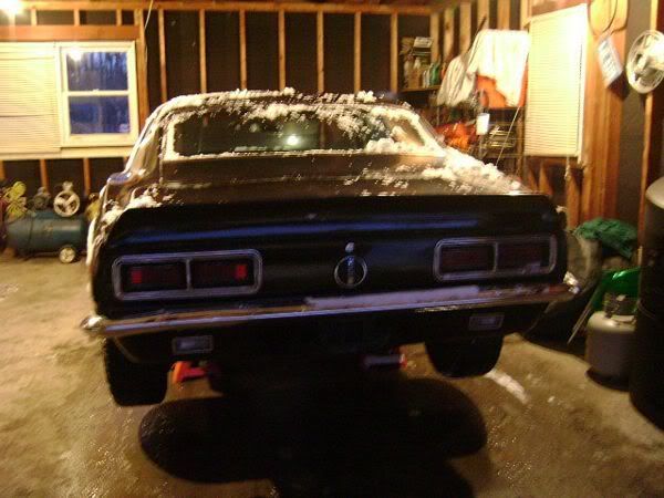

TBLEV 02-22-2009 03:16 AM
Re: BE 12Bolt

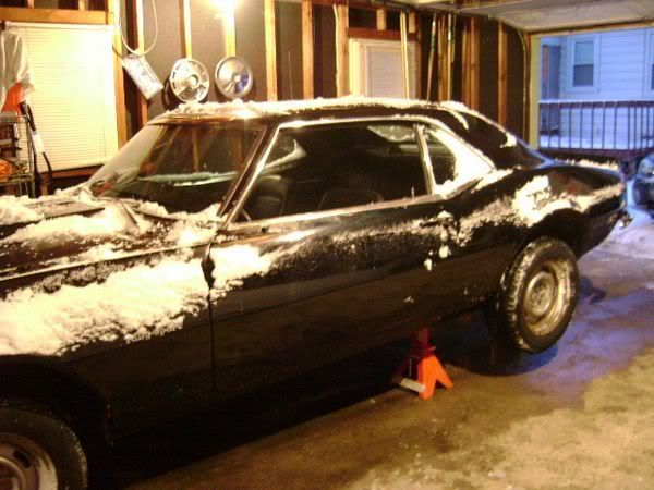

getting closer, got a little snow today but finally got it in the garage. wont be long before i find out whats inside the rear

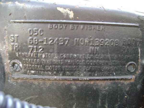

TBLEV 02-22-2009 03:22 AM
Re: BE 12Bolt

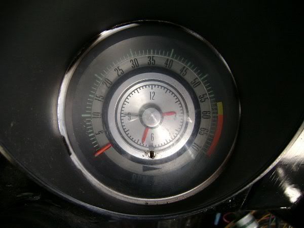

few more pictures, trim tag
http://i722.photobucket.com/albums/w...n_DSC00894.jpg
tach,
http://i722.photobucket.com/albums/w...n_DSC00902.jpg

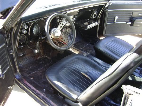

TBLEV 02-22-2009 03:25 AM
Re: BE 12Bolt
front brakes
http://i722.photobucket.com/albums/w...n_DSC00911.jpg
http://i722.photobucket.com/albums/w...n_DSC00912.jpg
interior,
http://i722.photobucket.com/albums/w...n_DSC00903.jpg
http://i722.photobucket.com/albums/w...n_DSC00935.jpg

You got the pic posting down https://www.yenko.net/ubbthreads/imag...iggthumpup.gif your car is a good one to restore, with what you have said I would say it is a 375hp car by the big block heater box and 6k tach https://www.yenko.net/ubbthreads/imag...ns/naughty.gif take a pic on the frame mounts for the engine, and bolt holes on the tranny cross member. That would really be a good one to keep if you can Todd https://www.yenko.net/ubbthreads/imag...lins/beers.gif

I'm in suspense......The car is on jack stands...Did you spin the rear to see if it is 4.10 posi? that's an easy way to tell if it is not original inside....assuming it is an original COPO rear

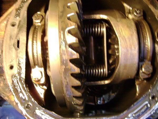

TBLEV 02-24-2009 12:59 AM
Re: BE 12Bolt
took the cover off today, looks like the real deal. per the info i recieved from members thank's guys. have a look at a few more pic's.

Clearly, the BE rear is a great bonus, but to the car.... if the 6k tach, b/b heater core, and 15" wheels, are all original to the car, it can only be one of two thing. 1. a Yenko with COPO9737 Sports car conversion package, or 2. an L78 that Yenko ordered to convert to 427, and never got converted.
If the tach and heater core are original, and the tire sticker is not, it's probably an L78. If the tach and tire sticker are original, but the heater core is not, it's probably a Z/28.
If none are original to the car, well then, it could be almost anything.
With the exception of the last one, all of the other possibilities are good, but of course, scenario 1 is the best. (I personally think scenario two is the coolest)
enio45 02-24-2009 06:24 AM
Re: BE 12Bolt
For 68, if it had the copo sports car package 9737, the trim tag will tell if it IS or NOT. Can we get a pic of the trim tag?
enio45 02-24-2009 06:29 AM
Re: BE 12Bolt
I just re-read the post - and the trim tag was in the pics....so, from what i can see, its not a 9737 copo car nor a yenko or non converted car. At least based on the data we have about yenko's and non converted cars.

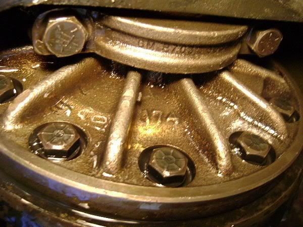

69L72RS 02-26-2009 12:02 AM
Re: BE 12Bolt
1 Attachment(s)
Great score. Looks to be all original and intact.
Please post the casting date and assembly date for the posi unit.
From your picture the assembly date will probably be stamped on the counter balance boss like the one I have attached.
The casting date will be by the crosspin bolt head.
Thanks in advance.
Eric
TBLEV 02-26-2009 03:34 AM
Re: BE 12Bolt
best i could do on a picture of a casting date
http://i722.photobucket.com/albums/w...DSC01028-1.jpg
assembly date
http://i722.photobucket.com/albums/w...n_DSC01039.jpg
