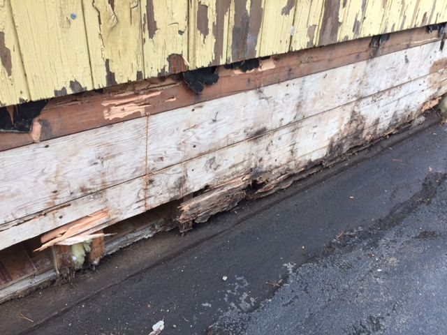

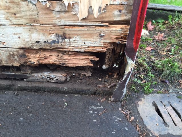

After getting this done we discovered the entire remaining sill was rotted. Don't know how two car guys who have had to deal with rust over the years would thing a building was any different.
A sample of what we found:
http://i285.photobucket.com/albums/l...psru3nl2my.jpg
http://i285.photobucket.com/albums/l...psfmzgopnq.jpg

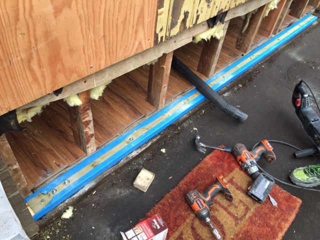

We peeled back the Tyvek and opted to do a bottom up repair replacing the sill and the botten 12 inches of stud along with scabbing in brace pieces.
http://i285.photobucket.com/albums/l...pssz3ipteg.jpg
http://i285.photobucket.com/albums/l...psdm88rrte.jpg

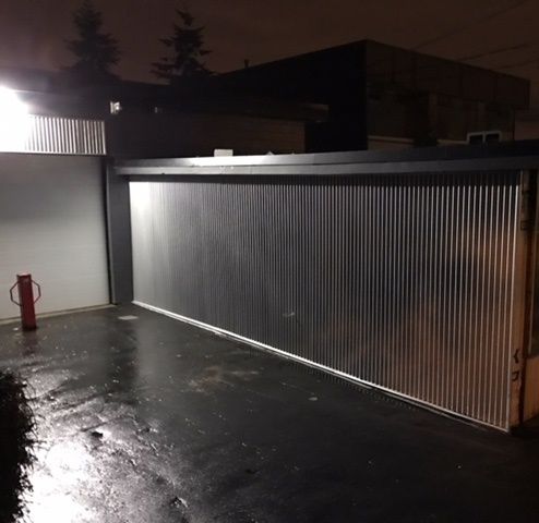

After everything was complete we were able to complete the siding, All this word was done Oct 27-29.
http://i285.photobucket.com/albums/l...skk0j4z4k.jpeg
http://i285.photobucket.com/albums/l...slscr0thw.jpeg
