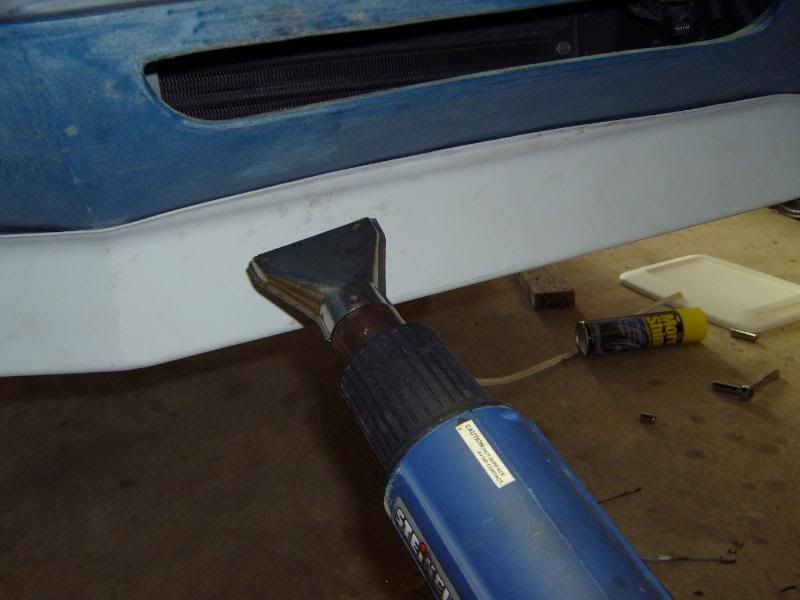

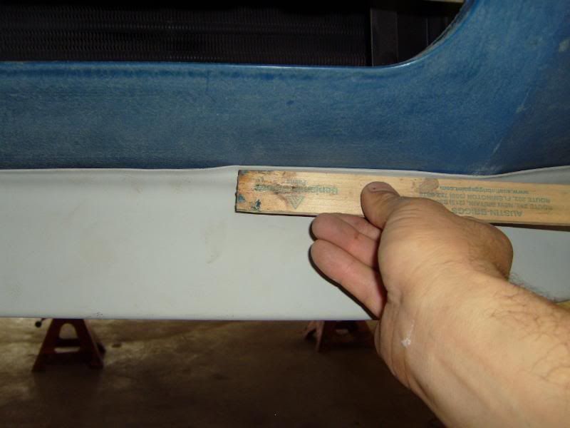

The front spoiler was the worst. Before I started there was a 3/4" gap between the spoiler and the valance. This was due in part to the factory misalignment when they glued the rear support section to the front spoiler section. I used the heat gun and softened the rear portion and moved it forward, which then reduced the gap to 3/8 inch. After that, it was heat the edge, push with a wooden paint stirrer and then hold til the plastic cooled, then repeat along the entire edge of the part.
Here is the spoiler after I fixed the rear support and started on the driver's side, reducing the gap. You can still see that the gap is larger on the left side of the photo.
http://i68.photobucket.com/albums/i3...a/S7001352.jpg
Here is the heat gun in action:
http://i68.photobucket.com/albums/i3...a/S7001357.jpg
And the patented wooden paint stirrer tool holding the hot plastic til it cools:
http://i68.photobucket.com/albums/i3...a/S7001362.jpg

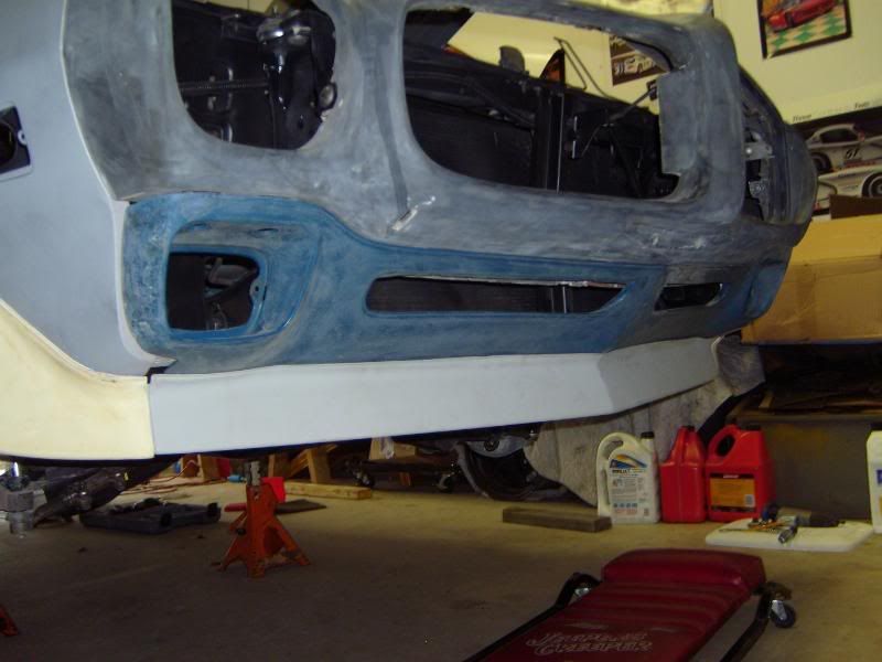

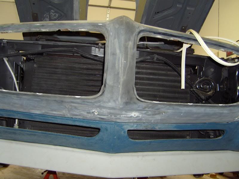

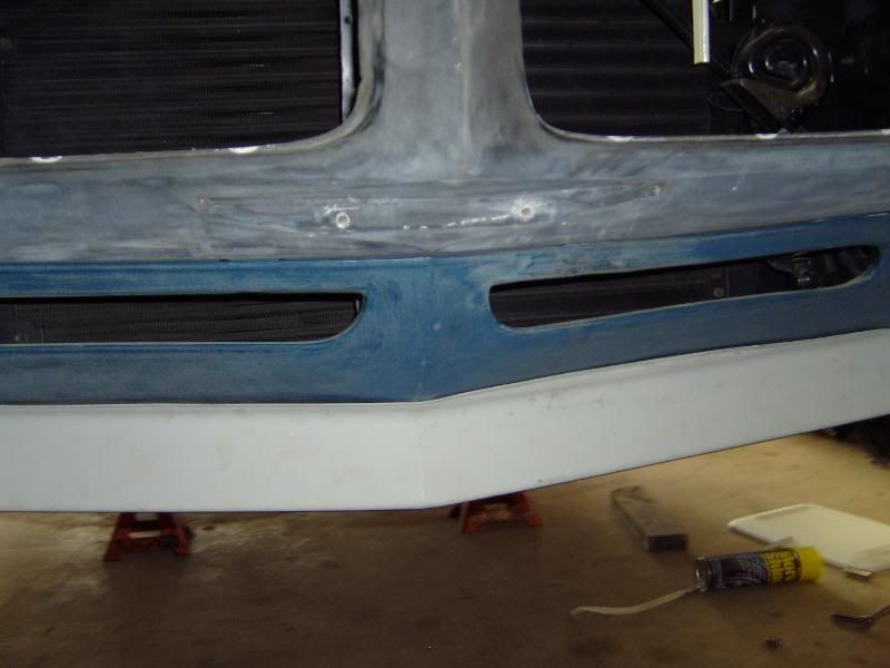

Here is the finished front spoiler:
http://i68.photobucket.com/albums/i3...a/S7001369.jpg
http://i68.photobucket.com/albums/i3...a/S7001376.jpg

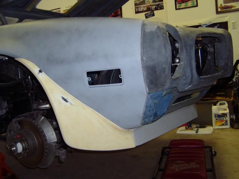

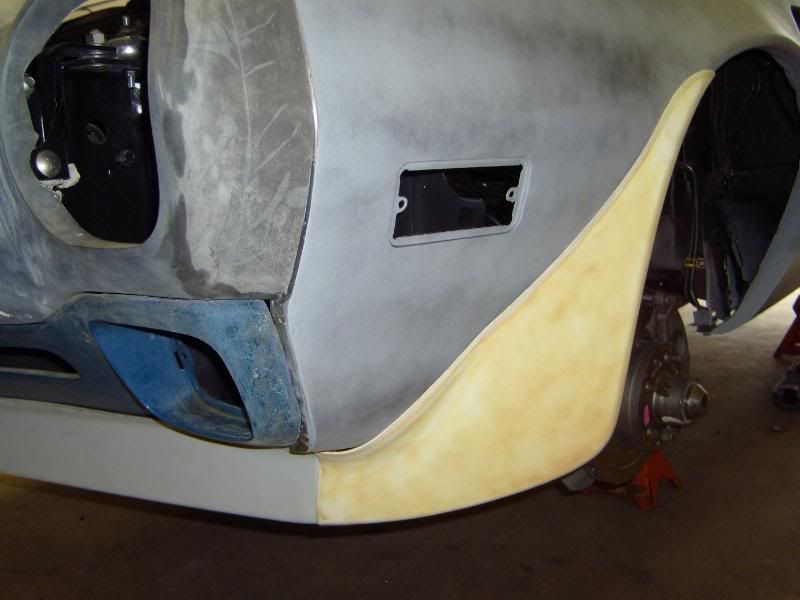

Here's the left and right front flares. It took a bit of massaging to get them to flow properly into the spoiler. The factory transition leaves a lot to be desired, aestheticly.
http://i68.photobucket.com/albums/i3...a/S7001373.jpg
http://i68.photobucket.com/albums/i3...a/S7001378.jpg

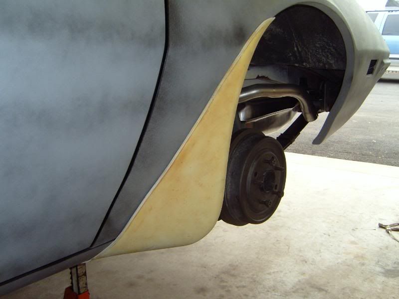

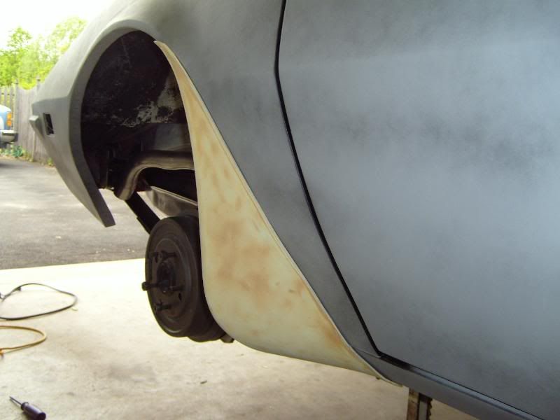

And the rear flares. Suprisingly, the majority of the screw holes in the flares actually lined up with the existing screw holes in the fenders and quarters. I only had to move and refill a couple, just so the flares wouldn't be under stress when they were bolted up.
http://i68.photobucket.com/albums/i3...a/S7001372.jpg
http://i68.photobucket.com/albums/i3...a/S7001381.jpg

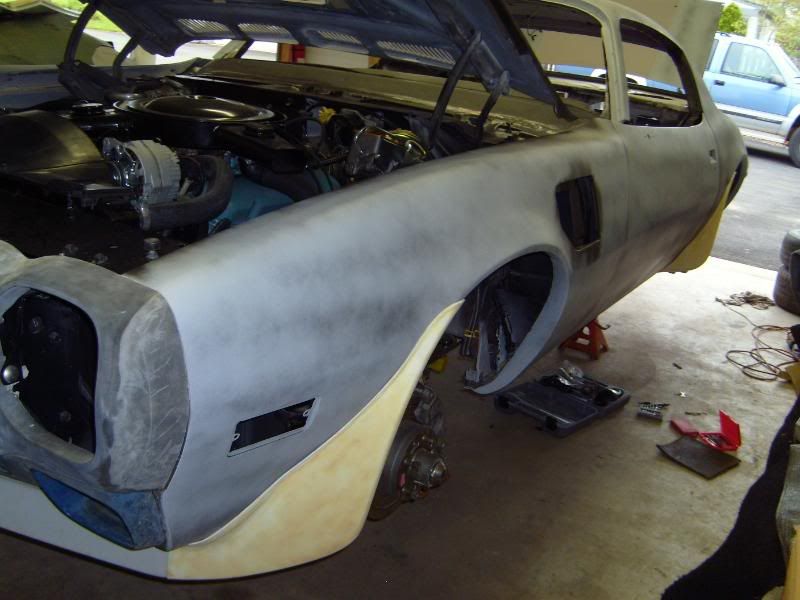

And the finished flares installed for final fitting:
http://i68.photobucket.com/albums/i3...a/S7001382.jpg
http://i68.photobucket.com/albums/i3...a/S7001385.jpg
