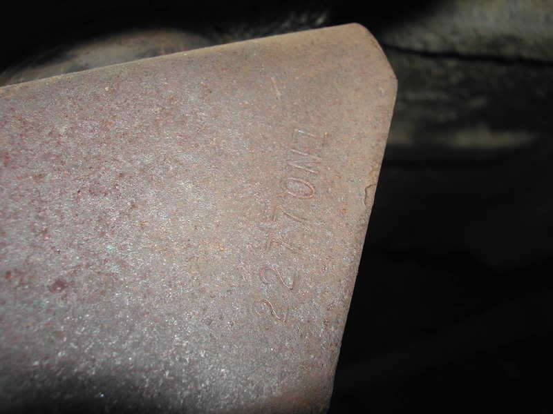

I'll check my other car tomorrow...its in my other garage a bit further from home...its a 31 k mile original Z...I'm real curious now...so are there any other stamps like this on the body or frame??? thanks, max
Jeff H 03-21-2008 07:25 AM
Re: 1970 Camaro hidden partial VINs
Mine was at the very rear of the subframe on the driver's side.
Hotrodpaul 03-21-2008 09:55 AM
Here is my frame stamping,1970 LA built Z-28 03B Build date, 124870L5105XX Vin. http://i3.photobucket.com/albums/y86...6/DSCN6300.jpg
Paul
COPO 70 RS/Z28 03-24-2008 05:37 AM
Heres my stamp It looks like 5 12 70 N ?
My car has a May 29 1970 build Van Nuys
http://i271.photobucket.com/albums/j...P3230150-1.jpg

RichSchmidt 10-22-2009 04:38 AM
I dont know about in 1970,or Van Nuys cars,but I own 3 cars,a 73 Camaro,73 firebird,and a 74 camaro.The number on my frames appears to be a part number,I could never connect it to the VIN trim tag or date{I did change the subframe in the firebird recently}.All my cars had AC,and the hidden VIN on the firewall is near the blower motor.I recently found one more set of numbers on the firebird that do mean something,but I didnt check them on the Camaros.On the bird,I found numbers stamped at the rear of the driveahft tunnel right over the pinion yoke.The numbers are similar to the beggining of the VIN and denote my car as a 1973 Esprit.It would be hard to rebody a 1970-73 Trans Am or Formula using my body shell since these numbers while not the VIN itself do identify the model of the car.
RichSchmidt 10-22-2009 05:00 AM
I just checked under my 74 camaro.It has numbers there,I couldnt make them out except that they begin in the number 1 as opposed to 2 like my firebird does,which seems to mean that it is a chevy.I looked at the subframe,and there was a little rust,but I could only make out 2 numbers,it looked like the number 31 was somewhere in between some other illegable numbers.the number 31 doesnt appear in the VIN or the body tag.Of course all my cars are Norwood cars with the 72 and later VIN format.I hope this helps.
CamarosRus 10-22-2009 11:39 PM
I'm thinking ...........
1) 1st digit is Month (but need to see what was used in lieu of 10, 11, or 12)
2) 2nd/3rd digit is day of month
3) 4th/5th digit is year (i.e.70)
4) 6th stamp is letter for frame mfg plant
5) 7th stamp is shift (i.e. 1= 1st shift)
COPO 70 RS/Z28 10-23-2009 07:25 AM
Makes sense Chuck
