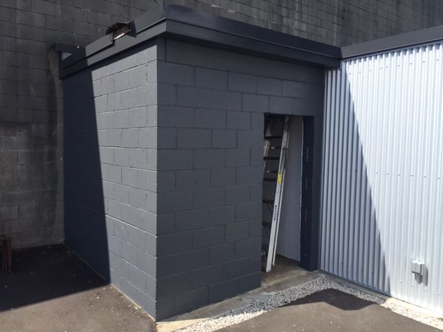

On the left is what we called the boiler room:
http://i285.photobucket.com/albums/l...ps6ahhqdva.jpg
This is what we took out of there:
]http://i285.photobucket.com/albums/l...psjplnfrkh.jpg
Then we took the chimney down.
http://vid285.photobucket.com/albums...psiplpypf5.mp4
Painting came next along with new facia and soffett:
http://i285.photobucket.com/albums/l...ps7u1vmlse.jpg
Everything painted out:
http://i285.photobucket.com/albums/l...psjbz1lclo.jpg
Inside was painted a bright white:
http://i285.photobucket.com/albums/l...psg4obmele.jpg
This will be home to the compressor, steel shelving for items we don't need in the shop.
Air and a outside water lines will be plumped into here.

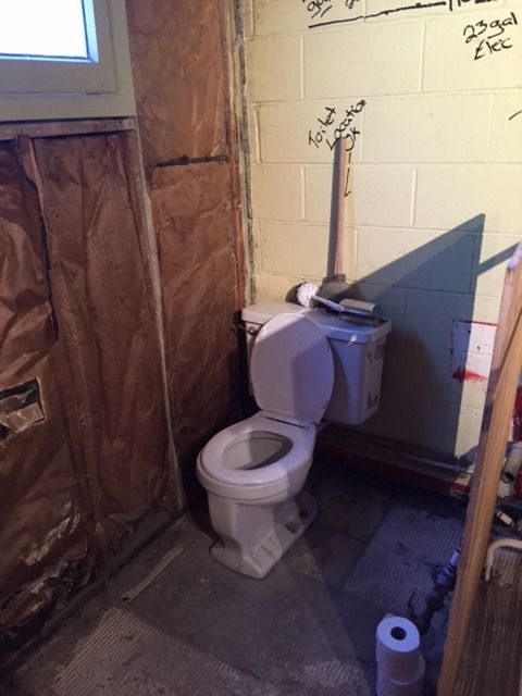

Here are some early photos of the three washrooms during demolition.
http://i285.photobucket.com/albums/l...psdud3xyh0.jpg
http://i285.photobucket.com/albums/l...psiq8em9bf.jpg
All unnecessary walls removed, all we had left was the &quot;prison toilet&quot;.
http://i285.photobucket.com/albums/l...ps0lilb6ld.jpg

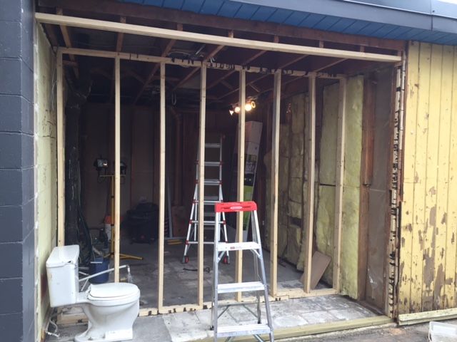

Lloyd and I were facing busy work schedules for September and had not done a lot in August due to vacations and other commitments. We decided we were going to demo and rebuild the exterior wall on Sunday Aug 28 with and early start and a commitment to get it closed on the same day:
7:00 AM new temporary support wall built into place.

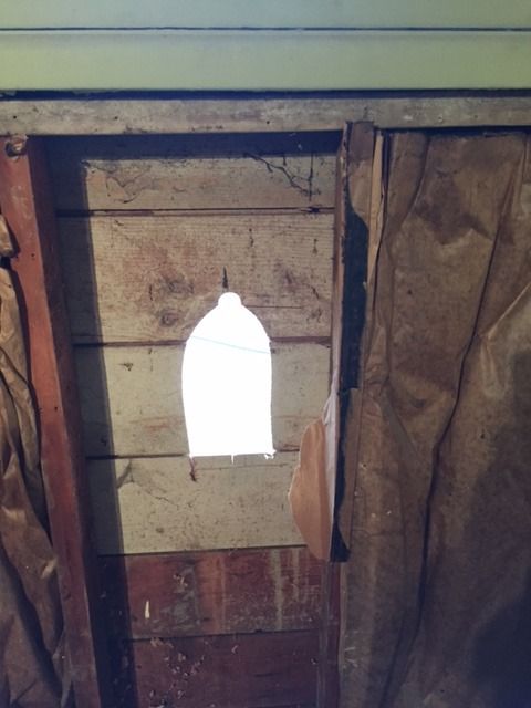

http://i285.photobucket.com/albums/l...psaur93f6t.jpg

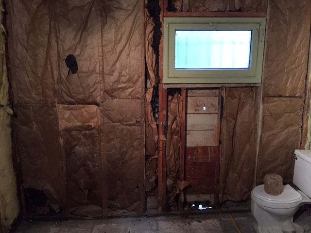

By 8:30 we had the old wall down, you can see the rot at the bottom below the window.
http://i285.photobucket.com/albums/l...ps2d8ui2al.jpg

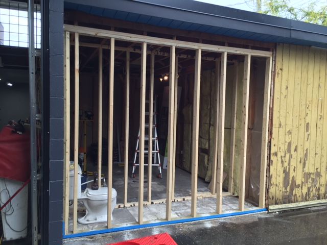

After cleaning, we stated building the new wall for tilt up. We got to this about 1:00 PM after a trip to Home Depot to pick up additional material. See sections of the old wall on the driveway.
http://i285.photobucket.com/albums/l...psbw4l18kv.jpg
We used pressure treated 2x4 on the bottom plate, then wrapped in Blue Skin waterproof membrane and with a Butyl rubber seal at the bottom.
http://i285.photobucket.com/albums/l...psqmznkw24.jpg
