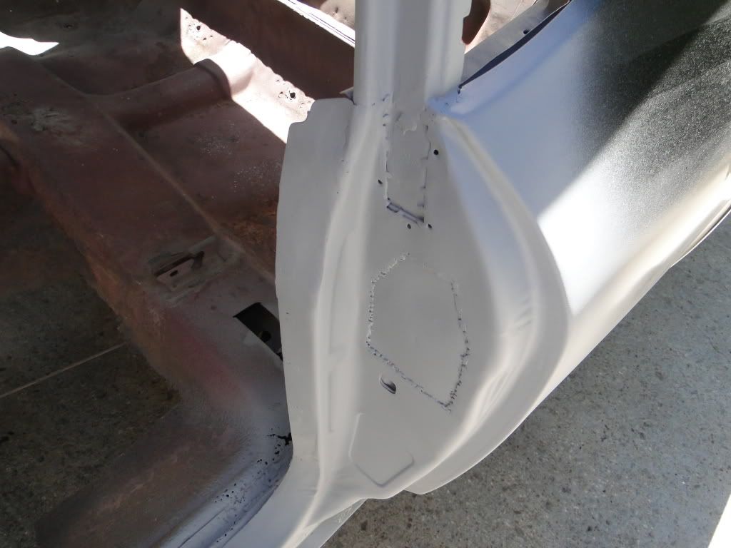

wheelhop 02-09-2013 12:27 AM
Re: 1969 SS396 300 Deluxe Post Chevelle - Puchased
4 Attachment(s)
Ken's been busy in Donahue, IA working on my old clunker! Here's some more progress pics!

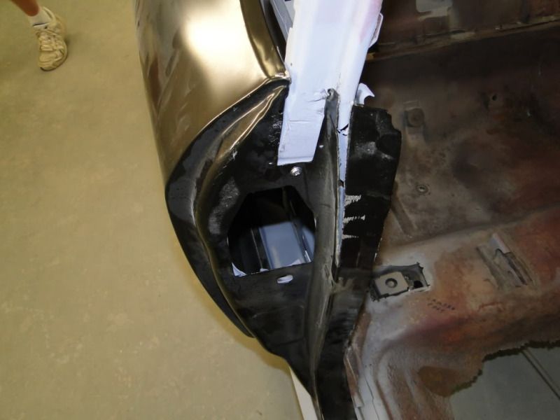

wheelhop 02-09-2013 12:29 AM
5 Attachment(s)
More
