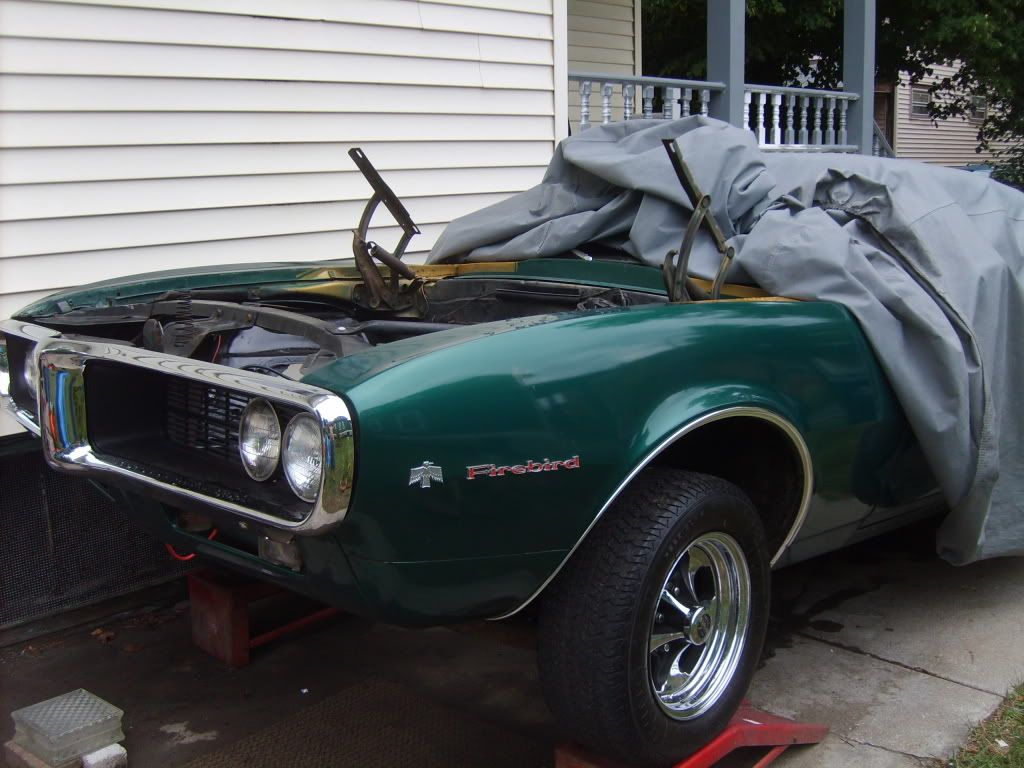

http://i852.photobucket.com/albums/a...r/S5000180.jpg

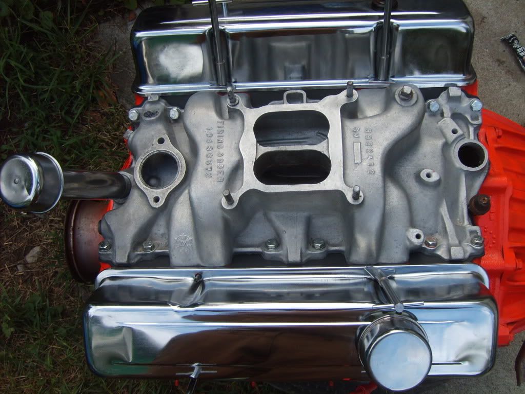

I started my &quot;Motorswap&quot;,the 326 Poncho motor was pulled out-I decided to use a 1969 Vintage SBC 350..It has all the Rite &quot;DAY2&quot; mods done to it..Its an 010 block with 441 Heads, OLD Crane &quot;FIREBALL&quot; camshaft-Double roller chain-Z28 Aluminum Highrise intake-Single point ignition with ACCEL-points -Wires-Cap&amp;rotor-APPLIANCE headers with THRUSH Header mufflers.For the drivetrain Im using a Muncie M21 tranny with HURST COMP+ shifter-and a ZOOM Street/strip Pressure plate &amp; SHEIFER clutch disc.I have a few pics,I will post more when it's Done-its gonna look oldschool...

http://i852.photobucket.com/albums/a...r/S5000191.jpg
