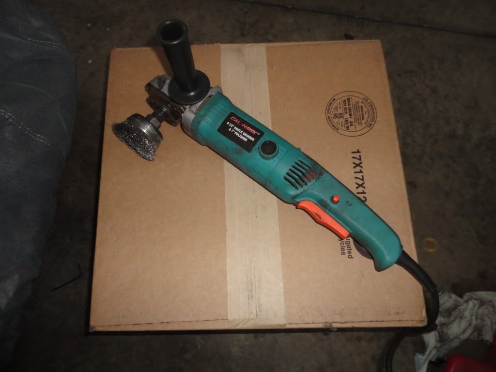

Here you go Mike......Nothing fancy.......But.....It's variable speed....the normal 4 1/2&quot; grinders run at 10-11,000 RPM.....Using the 3 1/2&quot; wire brushes works out verty well....but, without the variable speed, the grinder runs way too fast and the centrifical force just flattens the brush out and throws the wires right out of the wheel...So....this worked out perfectly....and it's small enough to get into most of those tight spots....
